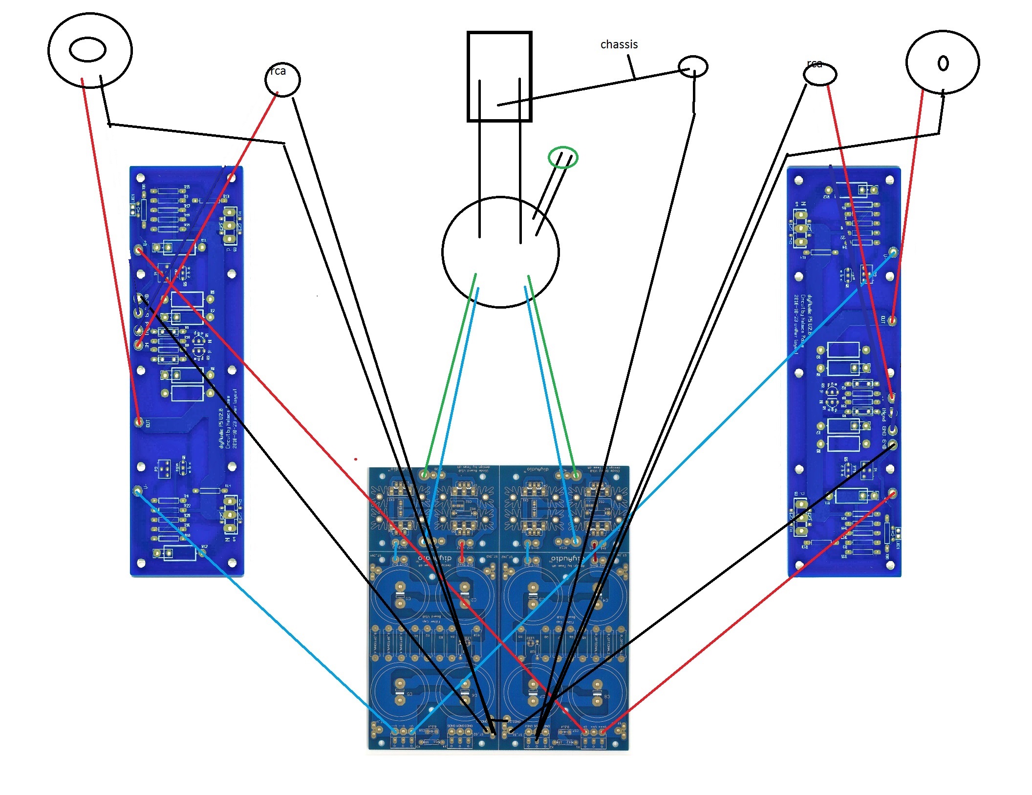

First pic is your design. Note that the grounds and the input cables form a loop around the entire guts of the unit. Connecting the source using two IC's completes that loop.

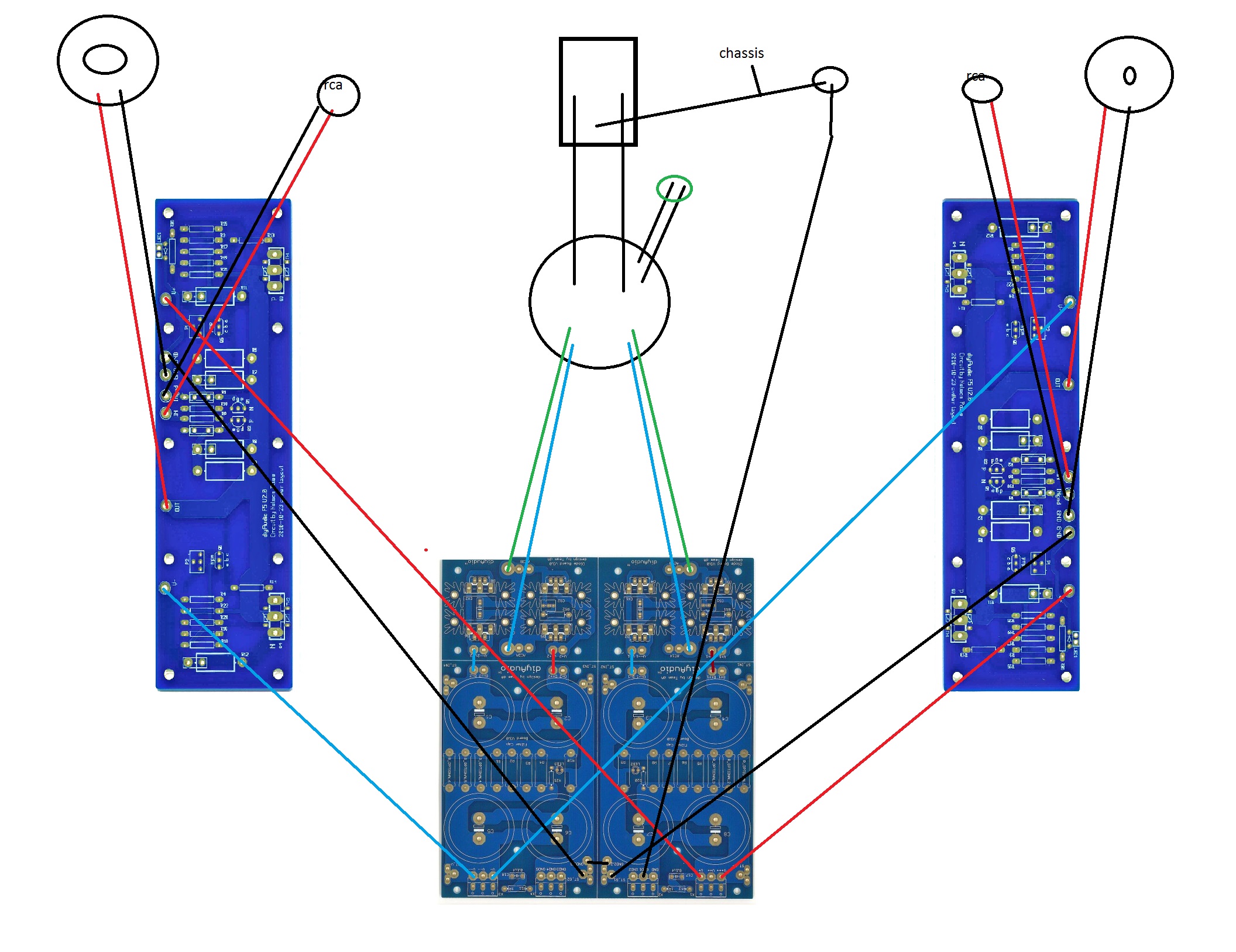

Second pic shows running one of the input cables, the right in this case, by wrapping it around the ground (green) to the common at the supply board, then the ground to the other channel, then to the left input jack, to the right input jack. Note that this arrangement gets rid of the loop in the power amp chassis. (pardon the crudity of my model)..
Note that you must wrap the external IC's around each other as well.

Why should I use this arrangement and not the original one?
LOOP AREA
I asked because I didn't understand the practical scheme and I want to try.
Googling I've found this grounding scheme:
"New solution: connect L input Rca ground to L black speaker out, do same on Rhs. Connect the two black speaker outs with a wire. Connect the centre of the wire going between black speaker outputs to the ground on the power supply. Connect the power grounds on each f5 board to the same ground point on the power supply that you just connected the input and output terminals to. DO NOT use the input and output ground points on the f5 boards. The f5 board should be connected to ground with only 1 cable."
It works if I connect the wire from black speaker to psu gnd on the same side emiboard (psu is splittable) and it works only for one channel a time
