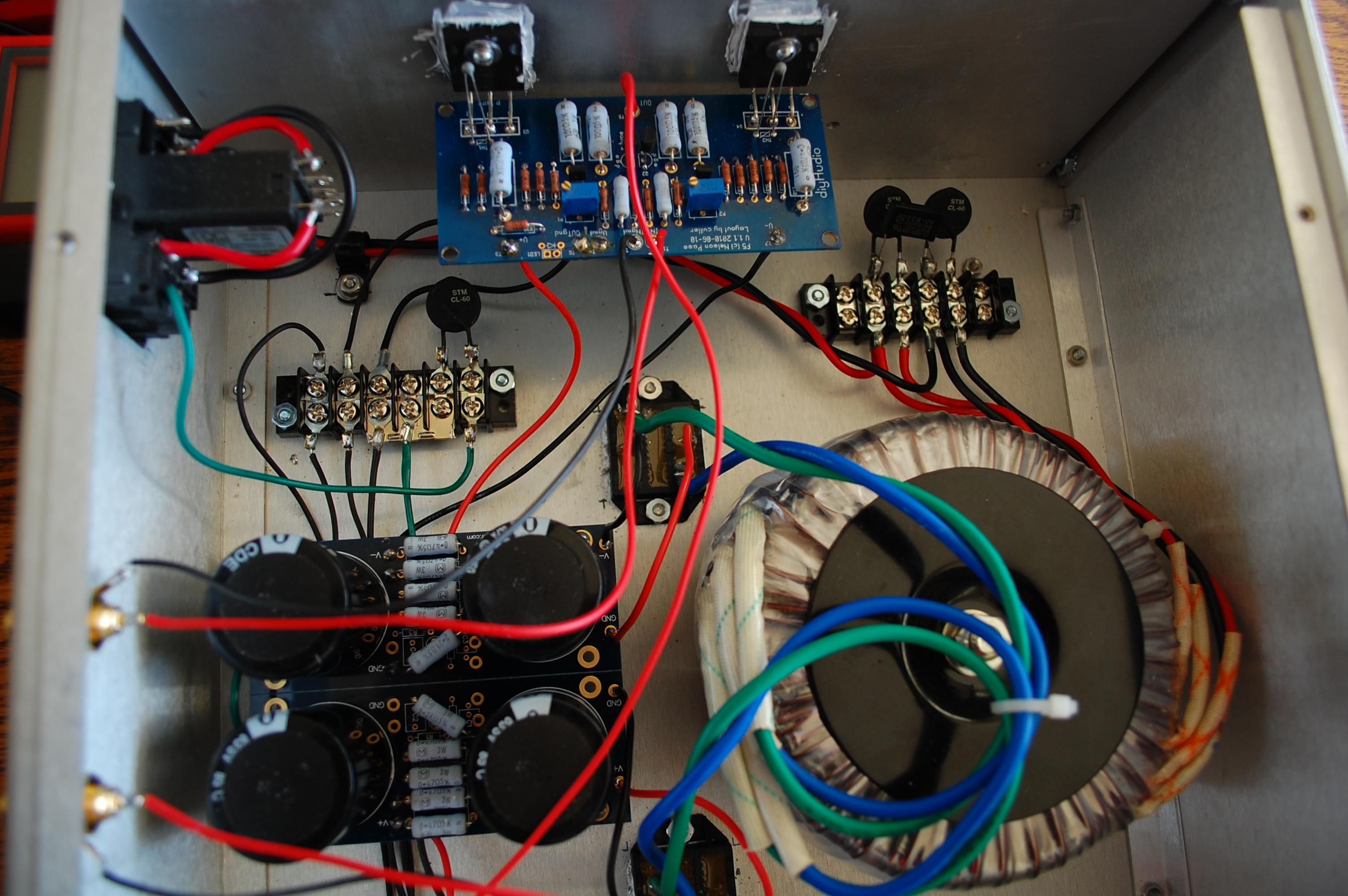

If the thermistor you are using has a painted flossy surface, then just make sure only that paint is touching the Mosfet.
The transistor body, or washer, doesn't really matter. It's the contact of the thermistor and the device that makes the best difference.
Ok thanks a lot, as long as that body can not conduct and into the chassis ground then all good 🙂
Actualy the thermistors have a grainy type surface, I couldn't find the type you guys and nelson use Orange/brown mine are.
also second prob is I have 2x 5A Slow Blow fuses 1 on each wire after the transformer. they blow when I turn the amp on with the inrush current so I Put in some household 13A fuses and problem temporarily solved
I think I even tried an 8A fuse and that blew! lol so at this moment I might just buy some 13A that fit.
Hold on, that doesn't sound right. Don't put in fuses that are higher rated than needed.

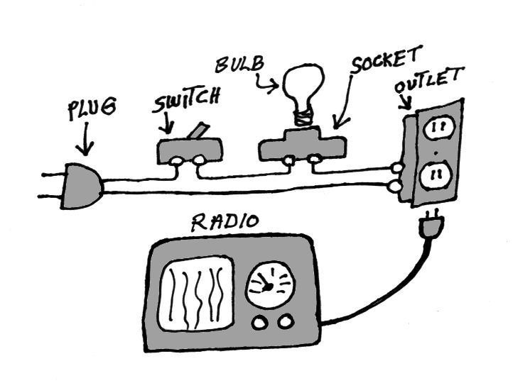

You might want to build one of those light bulb testing rigs. Put the bulb in seris with the primary. There are some examples somewhere around here.
Did you try some CL60 NTC thermistors on the primary side of the transformer? These will allow a slow turn-on. As the thermistor warms up, it passes more current.
See PS schem for F4 in PDF attached. Use the 240 version for UK, if that's needed.

Light Bulb Testing Rig - For Electronics testing
For safty, be sure all connections in the testing rig are fully insulated.
Only thing missing from the sketch is the earth ground. Include it as well.
If the bulb lights bright, there is something wrong, but circuit will be protected.
Some with better theory can explain it better.

To me it sounds like you have fuses on the secondary side of the transformer, possibly in the DC after the rectifiers.
You need only ONE fuse and it can go in series with one of the primary wires. This will be a lower rated fuse because the power coming in is at 120V, so you only need a few amps of current, then the transformer reduces voltage and increases current on the secondary side. This is why I suspect you are using fuses on the secondary. Also using one single fuse on the primary means that if it blows EVERYTHING shuts down all at once. You dont have to worry about one rail being on while other is off.
Edit: I see you DO have a fuse on each rail. Dont do this. Its bad juju.
Also lol, say there was a fault, If one fuse blows then it would mean only one half of the AC would be working.
Which could make it so only the positive half of the power supply is working, so Im just wondering what would happen to the amp I presume it would be ok.
If the F5 misses a rail, it puts out a full-rail DC offset for a half second, and then the offset stabilises pretty close to zero and music plays just fine. There is some discussion on this in one of the posts on this thread.
Found out the hard way when one of the rail cables worked loose, my speaker took it on the chin and survived.
Cheers!

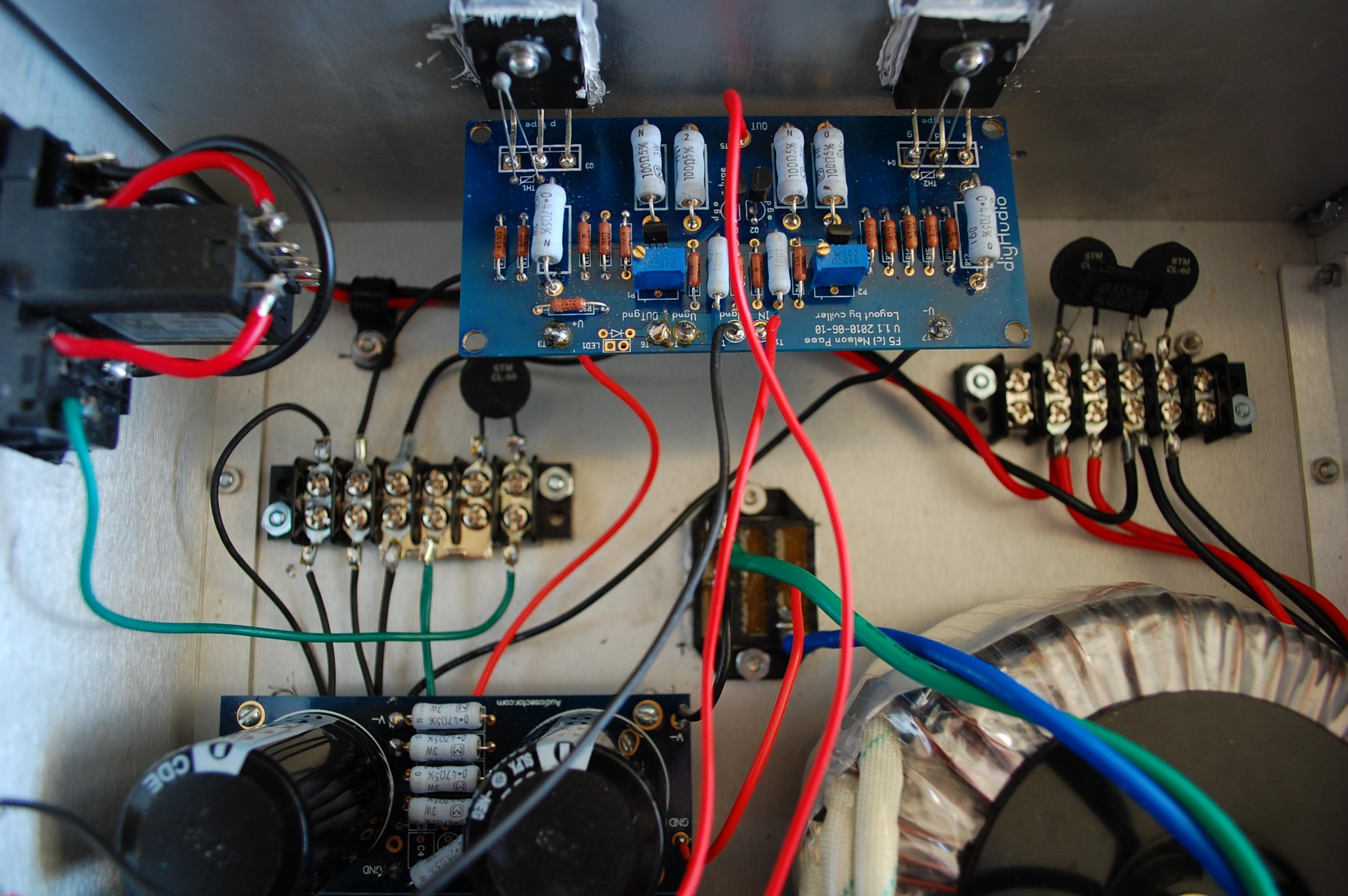

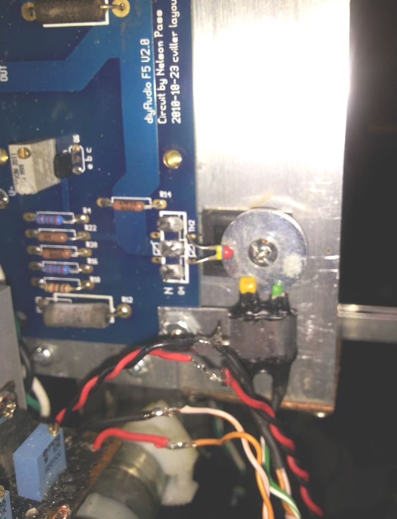

Do we know if the Thermistors have to touch the metal washer or Mosfets ?
Im worried about touching it against the washer in-case It makes a short circuit, perhaps I should put a bit of Mica over the thermistor to insulate it ?
You should worry. I smoked my first F5 build due to a crack in the paint on a thermistor that caused a short to the MOSFET drain lead. In subsequent builds I have used thermal epoxy and a tiny piece of mica between the thermister and the drain lead.
Hi, there is a CL60 NTC on the power in to primary of the transformer
vdi_nenna, my PSU has only a single centre tap wire so cant put the 2 NTC on.
Amp works fine i presume that just the inrush is blowing fuses.
udailey, I have fuses on the secondary one on each secondary wire before caps, I have 2 secondary green wires and 1x black centre tap. I have a fuse on the primary too before the thermistor. that was blowing too at 6A. Im on 240v here.
Ok i shall remove fuse on the rails and just have one main fuse on primary side.
sangram, yes when I was putting the oversized 13A fuses in I noticed one didnt go in properly. I ended up with the amp playing only the positive rail, as you say still played music but was half missing a bit distorted.
Exactly my point, this is my plan then, thanks 🙂 and my washers fill the whole Mosfet so I cant lay the thermistor against it as all there is is washer.
I'm not sure what you are describing. This pic shows two extra thermistors for a cooling system, but they all work well on the washer.
Yes, no problem there mine looks like yours, i was going to have thermistor touch the black Mosfet case but cant as washer is massive so will have thermistor with a small slice of mica in-between.
I Don't want to make same mistake as post #13272 🙂
