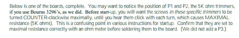

Hi, another F5 smoker here.
Today I tried to set up bias on my cascoded and doubled output F5. Tried first only one channel with a bulb and everything went fine. Once I pluged amp without bulb and tried to set up bias, one of the P fets warmed dramaticaly more than others. Measured values (P pair only) on 0.47R were 0.1V and 0.15V.
What a difference! Desoldered and checked both P irfp's matching again, fine! Both IRFP9240's have same value!
So I put fet's back and tried to set up bias again, this time a little more open. It took maybe two or three seconds and resistors 47 ohm R13, R113 fired!

If the gate resistors burned and smoked, something is oscillating. When you replace the gate resistors, use a higher value - 470-680ohm. That will help with oscillations.
Also check your feedback loop.

One way to read this is that you did not return the pots to zero after unplugging (bypassing) the bulb? Not sure why one would try to set bias and offset with bulb in series, unless it's a sanity check?
The amp won't bias properly with a bulb on the mains, the current draw will light the bulb, keeping the voltage/current low, exactly as it's supposed to.... You can, however, get the pots turned up to a point with the bulb in series that will be much too much when you remove the bulb - but too much bias isn't usually a huge deal, it's just really hot, and easy to turn down.

I hate to admit it, but my trimmers are mounted backwards. I had forgotten that and had to resort to using the meter to rediscover my error. Everything biased correctly a few days ago, doing everything in reverse.
Steve and Matt are wrong, the Bourns click both clockwise and counterclockwise. And they must be zero Ohm initially, and certainly not 5K.
The 'Steve and Matt Document' contradicts initially setting the pots to zero:
Which makes no sense. Max resistance will draw maximum current, and thereby maximum bias.
The 'Jim Document' has a detailed bias procedure - http://www.diyaudio.com/forums/pass-labs/188691-illustrated-guide-building-f5.html
They said that they measured it, but perhaps they were reading something different by measuring in-circuit. ?
The F5 manual advised setting the pots to zero for initial adjustment.
Initial Adjustment
Before applying power to the amplifier, you will want to set the values of P1 and P2 to their minimum. Verify this with an ohmmeter. When it comes times to “fire” up the amp first time, if you have a Variac, use it, fusing the AC line to the amplifier with a 1A fast blow fuse. Turn the Variac up slowly, and if you haven’t popped the fuse, then go ahead and confirm the rail voltages to the channels. Each channel does not need to be attached to a load in order to adjust it. If the only load you have is the loudspeaker, I would advise against using it during adjustment. For each channel you will be adjusting P1 and P2 alternately in order to achieve 0 volts DC at the output and .59 volts across R11 and R12. Each time you adjust P1 you will probably have to go back and adjust P2 again, and so I recommend adjusting the pots in half-measures, alternately setting the pots half-way to their voltage goals and measuring the DC values. Unless there is something very wrong, when the output is at 0 V DC, the values across R11 and R12 will be equal.
