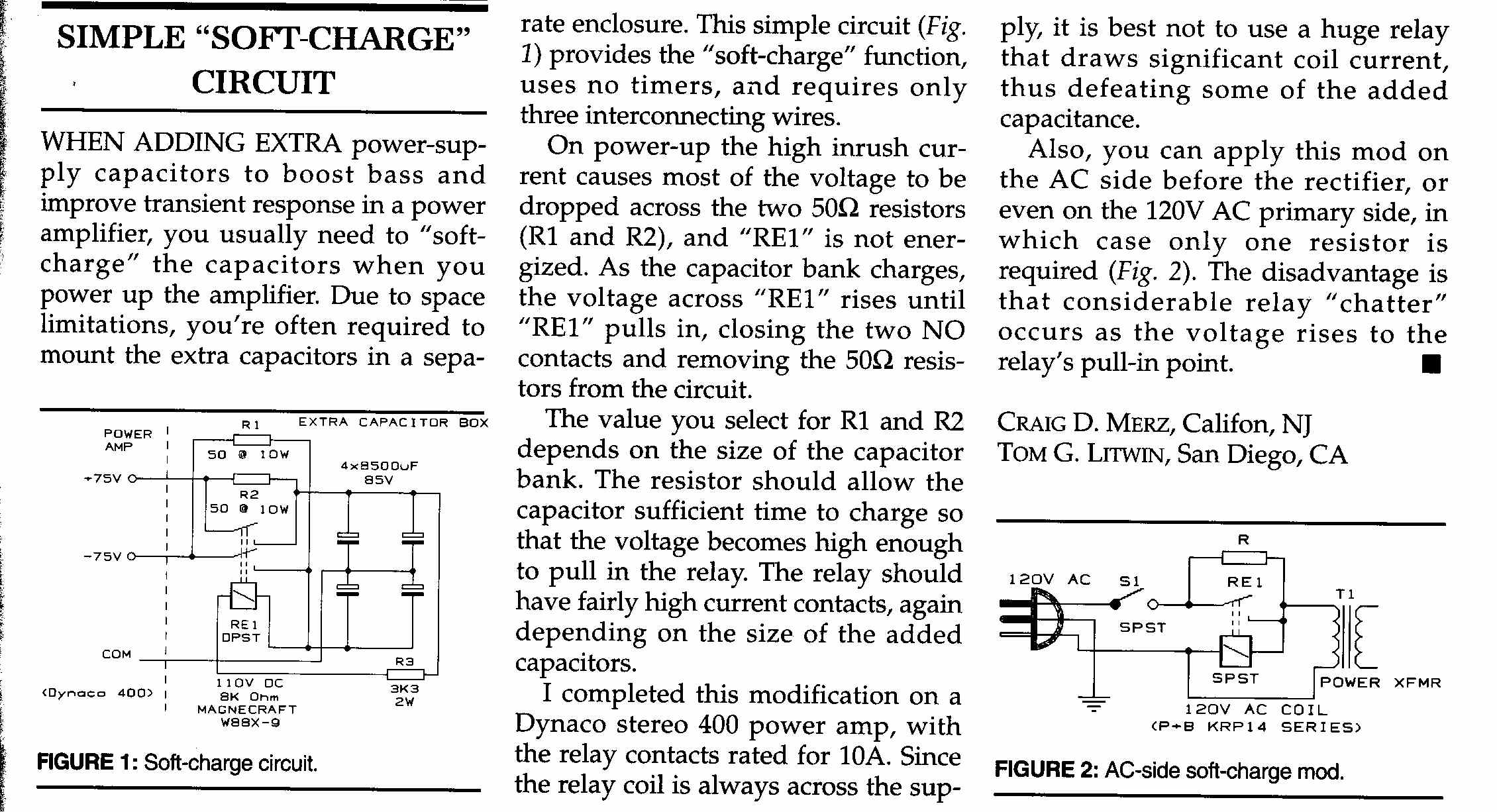

The CL-60 style thermistors are made to limit inrush current. They are at their highest resistance when they are cold, which will keep the current draw reasonable as the caps charge, and once they heat up, their resistance decreases, letting more of the mains through, keeping your efficiency up.
You also get the benefit of a little mains filtering, because of the (small) residual resistance.
That's a win-win in my book, AND you can use smaller fuses for better protection of your amp.
Win-win-win
i have 450VA and 148.000uF cap bank. and i use a modified hypex softstart. i pulled out the 33ohm resistors and put in CL-60's. it works as a sharm🙂 a original hypex will work too. but i like the CL-60's a lot more.
I live in 230V country and I have slightly larger filter caps and donuts compared to stock F5, but with a bit of luck, I can start it up with 2 A fuses. I use one NTC similar to CL-60 on the primary. Without the NTC, I blow 4 A fuses (2 A fuses literally explode).
If you hesitate when flicking on the power switch, the transients from the contact can heat up the NTC and result in blown fuses leading to periodical failures.

with one CL60 in line , I'm using T4A on 800VA Donut , combined with 8x33mF , in one of my amps , on 220Vac line
never had fuse failure , even in case of black-out ( worst case scenario for sole NTC based soft start)
well. let me be the idiot that screw that up😀 "blow" the main's fuse and pull it back on within a sec or 2😀(or 30) then it will blow the amp's fuse😀 however. if that CL-60's are bypassed a sec whitinin startup🙂
The CL60s and other Power NTCs used as current limiters need to be bypassed by a relay or similar to allow them to cool and to reduce the source impedance seen by the PSU.
If you don't bypass the NTCs then varying current in the amplifier will modulate the output voltage of the transformer due to the variable source impedance presented by the NTC/s.

I reported years ago about this voltage modulation when the NTC is not bypassed.
It is in the Krell KSA100 Klone Thread.
I could see the output clipping starting and getting worse as the (primary circuit) NTC varied it's resistance in response to varying output current.

FWIW: I ended up using Andrews formula (500 VA X 3 = 1500 / 120 = 12.5 A) and put two 6 A Slo-Blo in the dual fuse inlet. That prevented the blown fuses. I re-installed the thermistors and found no degradation of of sound quality. I did remove both F5 modules and test them on a chunk of standard heat sink. The output on each was back up to the proper level and that remained when I reassembled the entire amp build. The "starved" distorted sound probably had nothing to do with the CL-60, but rater some fault in the connections. I'm actually now getting the best sound quality and highest output since the beginning of the project. Might try to lower the fuse size back down a bit to increase safety margin now that I know the thernistors are working as designed.

Probably not a bad idea to bypass the thermistors with a relay after a short period so they cool down.
