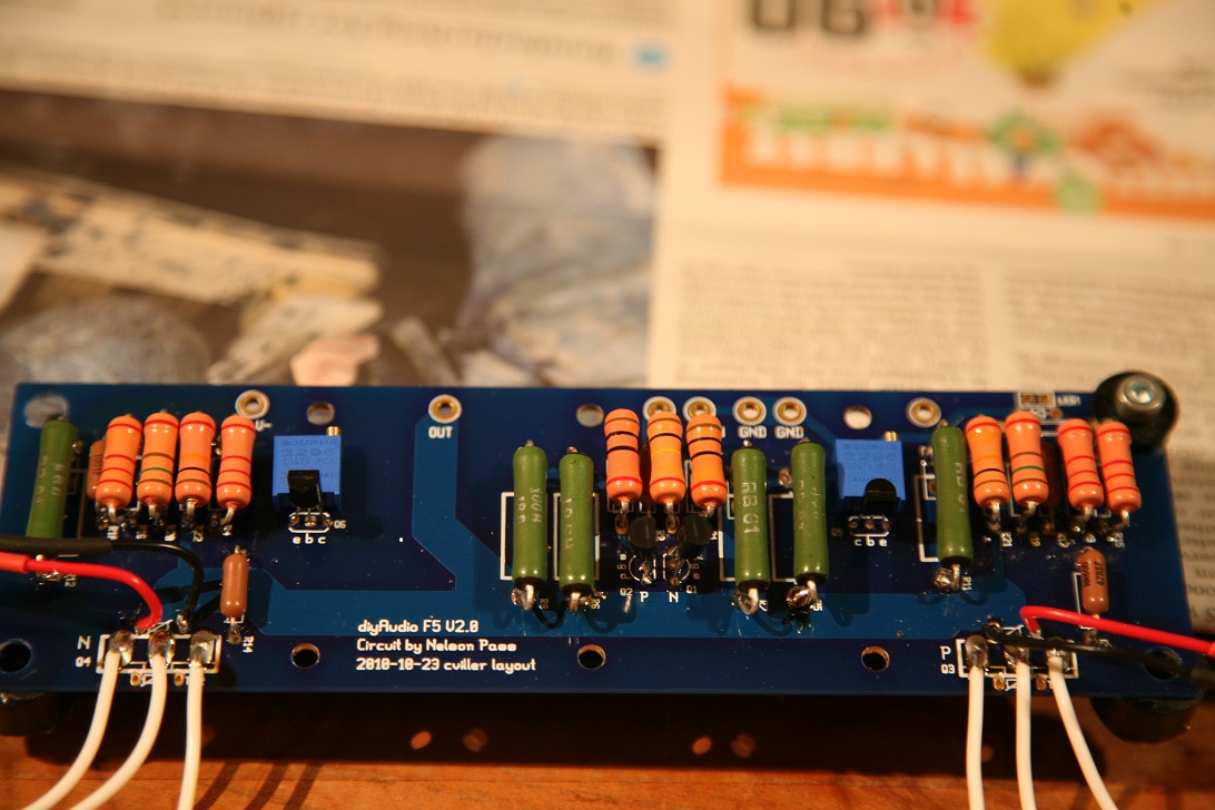

Hi There! I have some questions? On the output of my F5 I got 15mv and when I turn the pots they will climb in mv, but when I stop turning the bias will go back to 0.00mv. The mosfets are frozen. So what did I wrong. Did I positioned Q5 and Q6 wrong (BC560 and BC550) maybe? Thanks for the answer, Teake

one of the earlier cviller F5 boards did have a small error around one BC/ZTX 'conversion'
I think the board was correct, but lettering was wrong
don't know if yours is that one
best to look at spec sheets and cross reference with schematic

f5 finished. Thanks to everyone whom gave ideas on F5 problem last month. I changed transistors and it works perfectly.

your trimpots fell on their back
I'd check their solder joints, iiwy.

I know those boards all made about the same,so orientation is the same ,You can also pull those trans and measure where the supply voltage pin is then you will know for sure how they go,I hope I have helped some,Good luck!
