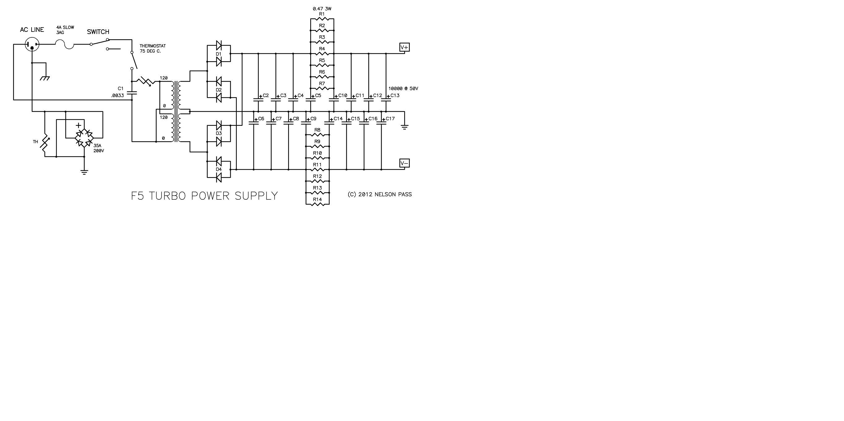

Walter -
Use only one bridge as the resistance between chassis earth and audio ground... having two seems like it will only add a potential loop.
Take the speaker return (black or negative speaker connection) from the amp PCB, not the PSU - it's much quieter that way.
Also, if possible, please draw a schematic of your wiring, it will help us understand your connections.
Nice work, by the way - neat wiring, good layout, I'm looking forward to seeing more photos of your amp! 🙂
Hi 6L6,
I don't know if I can use only one bridge, cause I have two separate main audio grounds. Or should I connect those first and then go through one bridge to earth? Hmm...
The schematic is attached, it's from the F5T. Only twice in my case; for each ampboard one PSU.
Thanks for the compliment ! I will post more.
Grtz, Walter

any reason why the diode bridges diodes are connected in paralel as one bridge, instead double bridge ? (or am I seeing it wrong)
The special audiophile rectifiers come in pairs with 3 pins and only one polarity.
You can't configure them as a standard 4 connection bridge, so you use them
in parallel.
Haha Tinitus, and I'm using those 'special audiophile rectifiers' 🙂
You can see them in my picture, the ones with little heatsinks on them...
Initially I bought the 35A/200V rectifier bridges, untill someone told me to use the special diodes. That's why I'm having 2 ground loop breakers😀

as nelson said. the 3 leg diodes have 2 paralell diodes in the same chassis. but ofcourse.
you can use twice as many. to form dual bridges.
Most of the 3 legs dual diodes rectifier comes in two types of configurations, either it is common anode or common cathode, standard bridge can be form by two dual diodes, one of each type.
But I don't know if this types of configuration also applied to "special audiophile rectifiers" or not.
