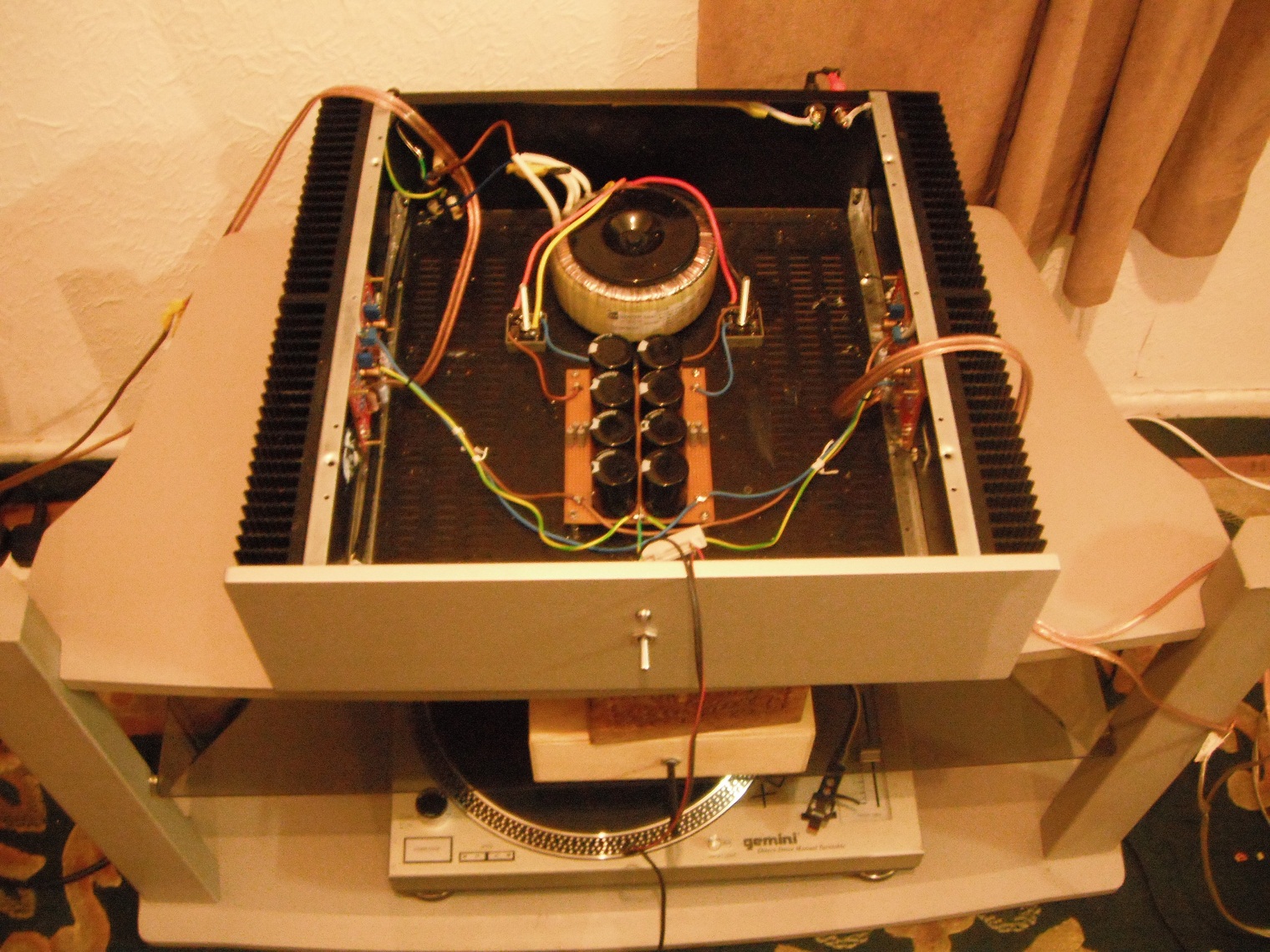

Well here is my F5, i actually built this for a friend last year which he has been running all this time no problems to my excitement he told me he wants to upgrade and buy something he can have insurance on so we went looking for amps and so far he has decided on a couple of "class-A" Accuphase amps lucky bugger!
anyway this was my third Nelson Pass amp and definitely the best sounding, although the Zen V4 sounded great too! this F5 beats it for me.
This was before we connected the speaker Terminals and LED up

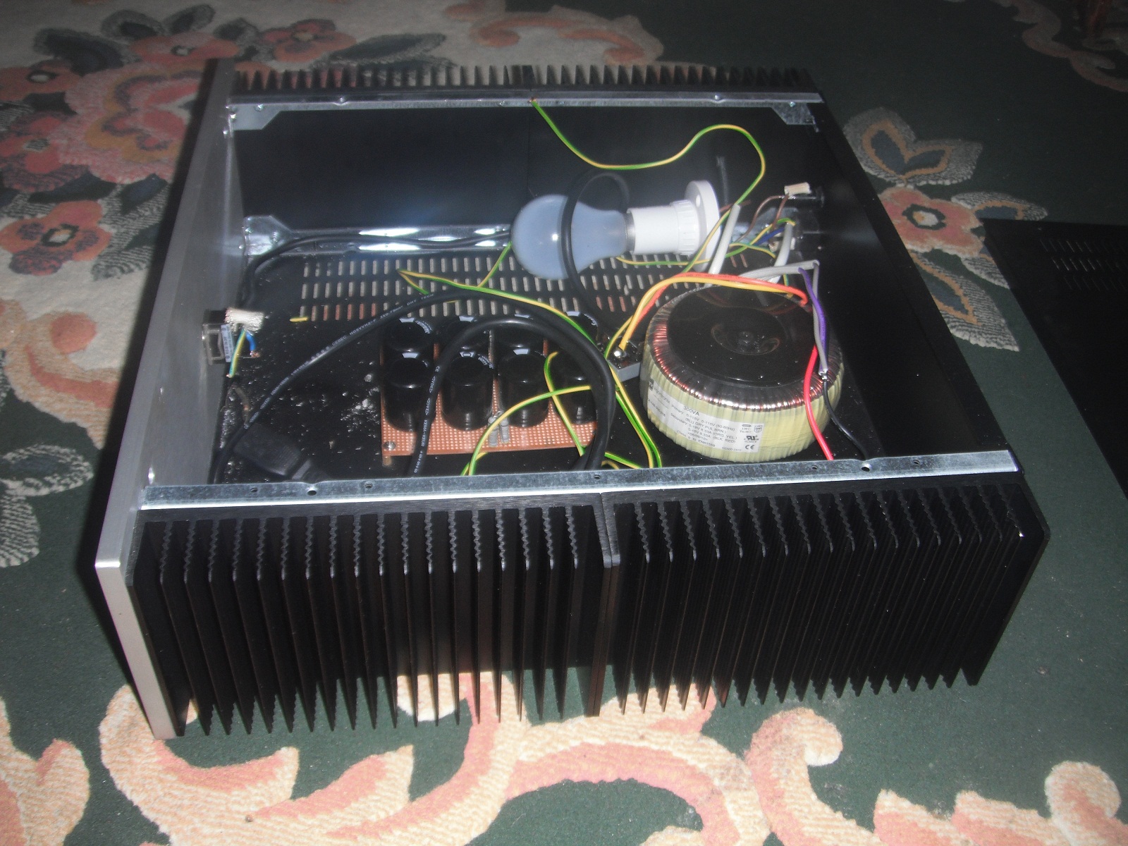

Light Bulb for testing the PSU, I wanted to be safe

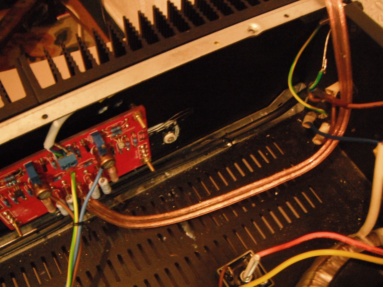

My only regret is that the boards I used were from ebay, perhaps it would have been wiser to get the more expensive but authentic boards. it was a money thing!

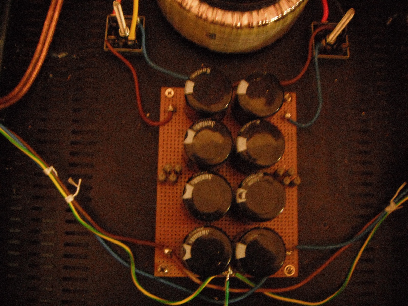

Heres how i wired the caps up on strip-board I think

I do have one question, there are capacitors on my board! but none on the original F5 any comments on that ?
Well There we go, if theres anything you think i could improve on let me know thx

They are non-approved boards... That kinda explains it. 😉

Yeah, i might get the proper boards, but then un-soldering the components and putting them on the new board is a bit time consuming, could just buy some new components, decisions decisions
which board would u recommend ?
i expect it wouldnt be safe to remove those caps lol
Nah, that would open a can of worms. Just get approved boards for the next one. 🙂
