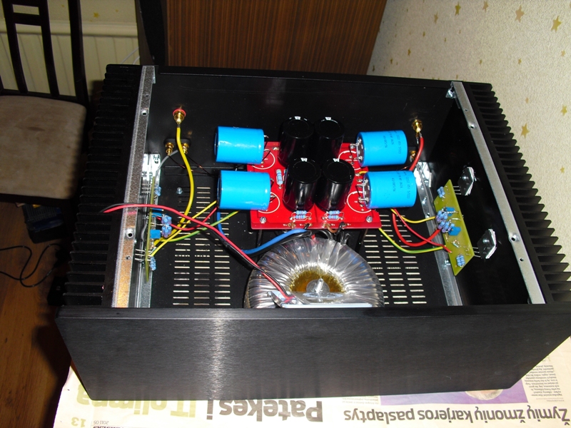

Hello to everyone,
just finished my F5, outstanding performance, thank you Mr. Pass :)
Donatas.
Very good amp Tolikas,
looks like you're thrown out protection circuit :cool:.
your source resistors is not too hot? it seems that you have 2x 0.6W (in my f5 i have 5w resistors and there is approx. 60 degrees on them).
Protection circuit has a negative effect on overal l sound quality, i have tested it before throwing out...
Those are 2x3w actually :)
