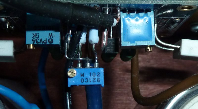

P3 pot thd
After reading recent messages about P3, I tried this evening some tests on a couple of my F5 monoblocks (Vishay IRFP240-9240). I used a 1k 25turn pot. Very interesting results, about a factor of 10 in less thd after fine tuning with Arta 1.7.1 and M-Audio AP192 (see pdf if you like). Tomorrow I'll listen some music to hear the difference.

P3 and tuning to 2nd harmonic
I observed very interesting phenomena. Even though I added some distortion i.e. 2nd harmonic and in this way THD is probably worse, but sound is more breathy and clear than before. Not only resonant as one can expect.
