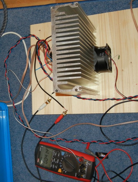

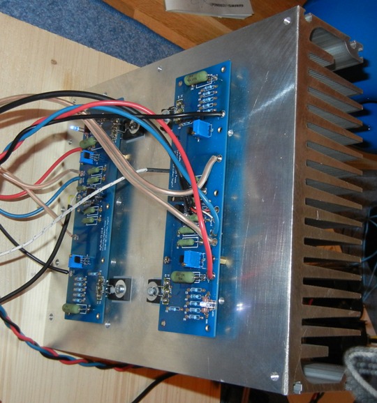

OK, I have tried some experiments with forced cooling - with a fan attached I can run one F5 channel on the heat sink at 34 degres C or both F5 modules on the same heat sink, the heat sink is 42 degrees C (with convection it was 54 degrees C with only one channel)
The fan I am using is a 24 volt unit with a 35CFM rating (with a 41dBA noise rating - very nosiey, but all I had at hand to test) - I am running it at 19V from an old switch mode laptop power supply (yes they do have uses) (I am having trouble downloading the derating table for reduced voltage - so cant really say what the CFM is at present , but it is less than 35 CFM)
I have the amp setup as per instructons, the supply voltage is +/- 23.5 Volts, for R11 and R12 the voltage is between 0.59 and .6, giving an offset voltage at the output at less than 2mV
Also I have used a fully encapsulated transformer (Noratel brand), it is rated at 225Va (I will 1 per channel) but at present I am running both channels off one transformer just to check for hum under heavy current load (and it is easier for testing, less wires every where), there is absolutely no hum - these appear to be a great solution for heavy current draw applications - under these conditions it is quite warm, about 43 degrees C
Other adventures - maybe this will help othes who make dumb mistakes like me - ie connect the power supply round the wrong way ( moral to the story is dont rush to test the amp , take your time and check and check again)- lots of glowing resistors ( R11 and 12 anyway) toasted Q3, Q4, Q1 and Q2. What really suprised me is that it also cooked P1 and P2 - check these as if you power up again with these cooked - what I mean is the wiper point was open circuit ad so I got the 5K which gives a high bias current and so R11 and R12 start to glow again and let out smoke.
