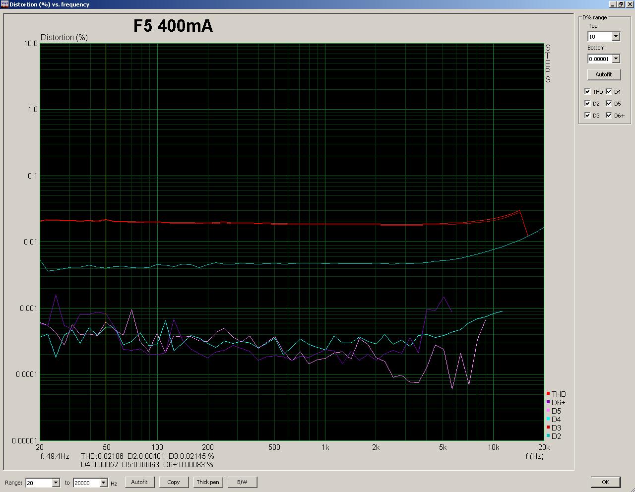

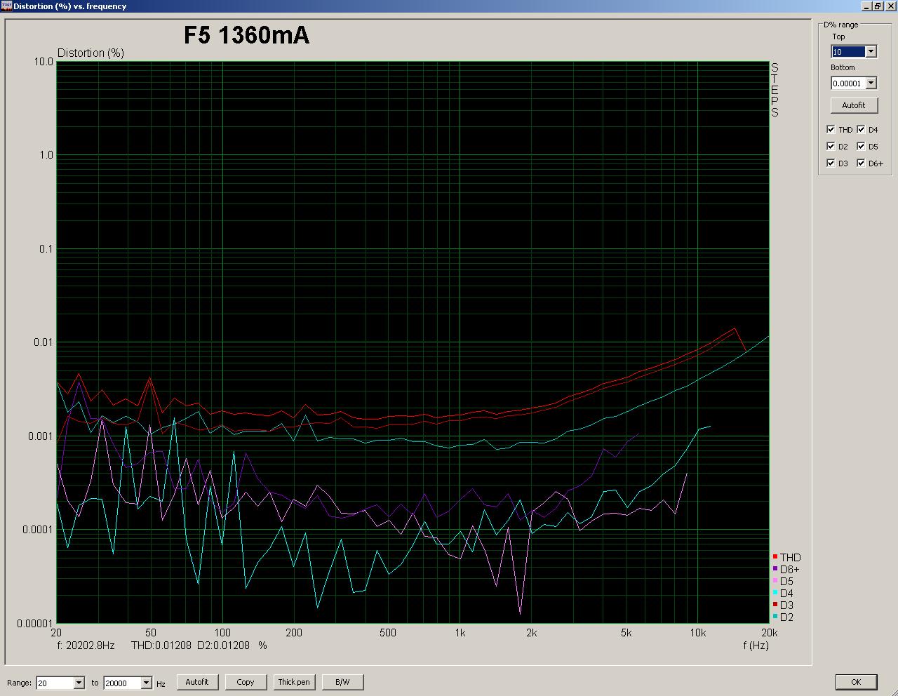

Very true. Here is a distortion vs bias curve for the F4 type circuit. In
Passlabs
You can see some distortion spectra and waveforms as well.
Does anyone have measurements of F5 with different bias currents ranging from 100mA to 1.3A?
I don't have any curves, but Nelson has always said to bias them as hot as your heatsinks can allow, as long as you are under 50W per device.
Yes I understand that more bias gets you lower distortion with mosfets and F5. But I am curious how much distortion would I get say at 300mA to 600mA per channel to obtain more power in class AB region. I can for sure test lower bias with my upcoming F5 by listening but I am also interested in numbers as I do not have any distortion analyzer.
1W / 8Ohm / 1kHz 🙂
Maybe an A/B class F5 amplifier doesn't sound as bad? How low has been an F5 biased while mantaining an acceptable grade of distortion?
In other words, does an F5 biased with 100mA or even 50mA per device sound better than, say, a Gainclone?
I have been wondering that since I built my F5. Now that I'm pretty drunk (holy christmas!) I dare to ask this 🙂

I am powering tweeters using an F5 biased at 500mA for more than two years .I never felt the need to go higher.It will not sound as good as with higher bias
I have another one biased at 1.3A.
Both sound really nice.

You can bias the F5 as low is you like. I have one here running at .5 A on my
TV audio and it works fine and the distortion figures are acceptable. I would
not be inclined to use it on my main audio system because it sounds better
above 1 amp.
