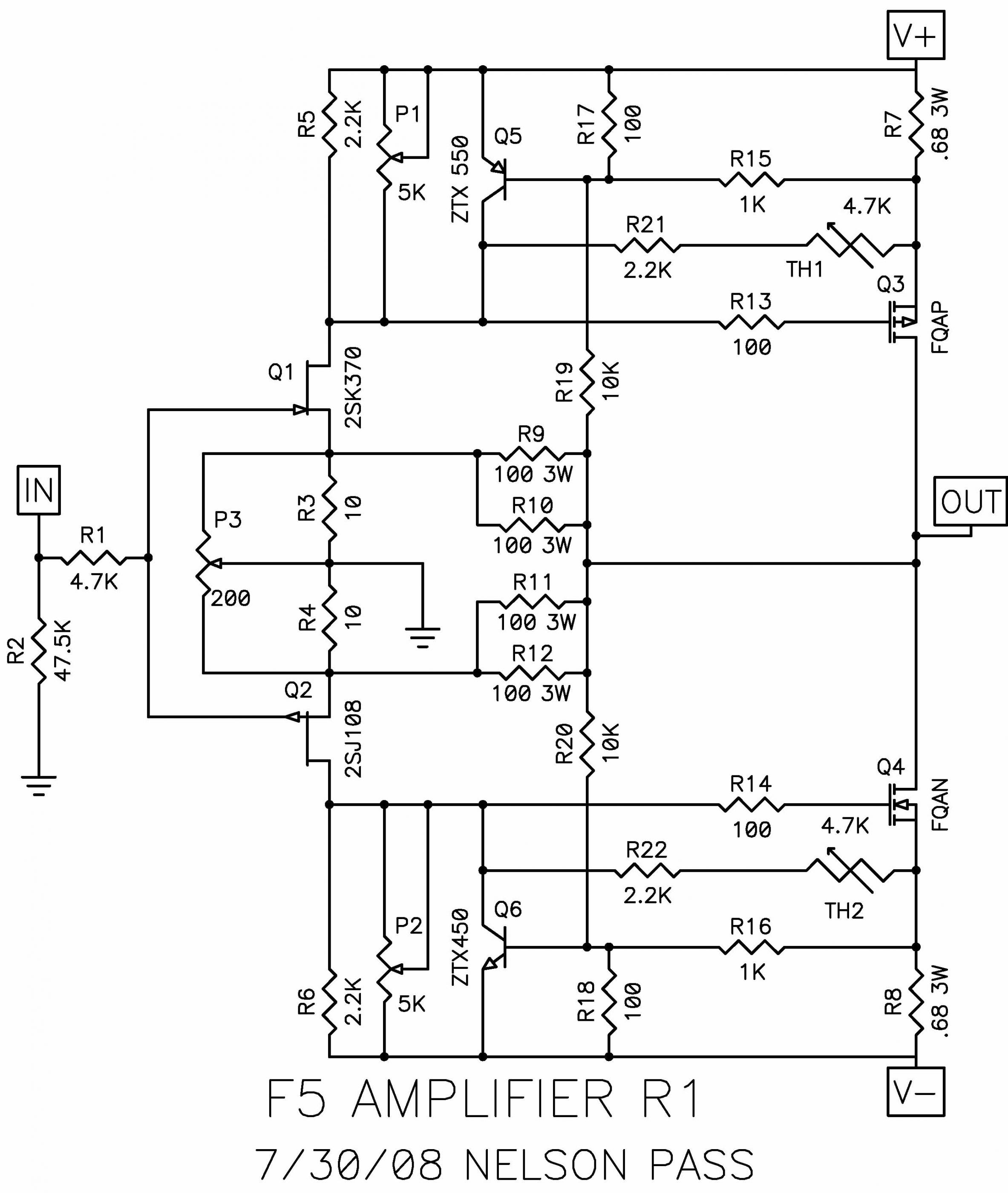

A May 2008 6Moons review of the F5 shows a few pics of the amp interior. It appears that TH1 and TH2 are 2K2 (4K7 on the schematic), and R13 and R14 are 150R (47R on the schematic). Anyone know why the deviation?

I'm a long time lurker who's just finished reading this thread :scratch2: and I'm putting the finishing touches on my first F5 build. I have a little confusion to clear up before I put the "firstwatt" to my build.
My build is on Peter Daniel's version of the PCBs and I bought the bits and pieces from TechDIY as "F5 kits". The Peter Daniel's board follows the original schematic, but the TechDIY kit is for the "R1" version. It was no problem to put a couple jumpers to modify the Peter Daniels board to follow the "R1" schematic and then install my "R1" parts kits.
Two questions before I risk some smoke.
What is the function of R1 (4.7k) on the new (left side) schematic ? The input resistor divider R9-R10 of the original (right side) schematic has changed in the new drawing. Should I jumper my board to match the new "R1" schematic for the connections of R1 (4.7k signal input resistor) ? I'm not understanding what current flows through R1 as drawn and what it's function is ?
I'm guessing the only difference in the initial set up of the original and "R1" version is to center (measure) the P3 pot prior to power on ? Any other caveats ? Is P3 useful for anything other than changing the harmonic distortion distribution ?
R1 and R2 in the Rev 1 F5 schematic fulfill the same roles as R9 and R10 in the original F5 schematic. Just different values. As described in the F5 Operation and Service Manual, R9 [now R1] is to prevent parasitic oscillation of the input JFETs, and R10 [now R2] is to provide a reference to ground for the input JFETs when nothing is attached to the input (i.e., the input is "floating"). See the section entitled "Actual Working Circuit" of the manual for these descriptions. In the Rev 1 F5 schematic, the input JFETs see ground through R1+R2 as opposed to seeing it through just R9 of the original schematic. 100k vs. 52.2k? Either works. However, I am curious as to the change from 1k to 4.7k for the "input" resistor. (I've not studied the circuit carefully enough to see what drove that change.)
I believe that you can simply omit P3. Note that in some earlier posts, there has been mention of slight adjustments to P3 burning out transistors....
Since the values of the source resistors for Q3 and Q4 have been changed from 0.47 to 0.68 Ohms, the target voltage across the source resistors has changed as well. The source resistors are R11 and R12 in the original schematic (0.47 Ohms * 1.3 A = 0.6 V) and they are R7 and R8 in the Rev 1 schematic (0.68 Ohms * 1.3 A = 0.88 V). I'm here using a bias current of 1.3 A.

Thanks for the response. It definitely answers enough of my questions to let me have a first try at bringing my amp up. I will remove P3 from my boards for the intitial set up and listening. Other than that, I am using the "R1" schematic and component values. Next weekend is when I have time set aside to run through the initial start up. Hopefully it will be music rather than smoke.
P3 in R1 schematic have same purpose as additional source resistor( of output mosfet) on one side - which you can see on any original FW F5 picture .
fine fiddle with signal gene + THD meter is needed for setting .
what's important is knowing that you must be careful , approaching extremes of that pot :devily:

Add in 51r to the top and bottom legs of P3 before tapping into the Source connections.
This raises the total resistance (of the bypass route) to ~300r and gives an adequate adjustment range for the 10r R3 & R4.
Gain of the first stage is P1/[(1/gm)+Rs] and is nominally 10, so adding 50R is going to get a bit closer to 10X from the original. You don't have to add P3 -- you can parallel values against one or the other against R1/R2 (Refdes from the original schematic).
I experimented with this and it doesn't take much tweeking of P3 to lower the THD. I'll state again, however, that right out of the box the F5 THD% is 0.006% to 0.008% @1W into 8R
