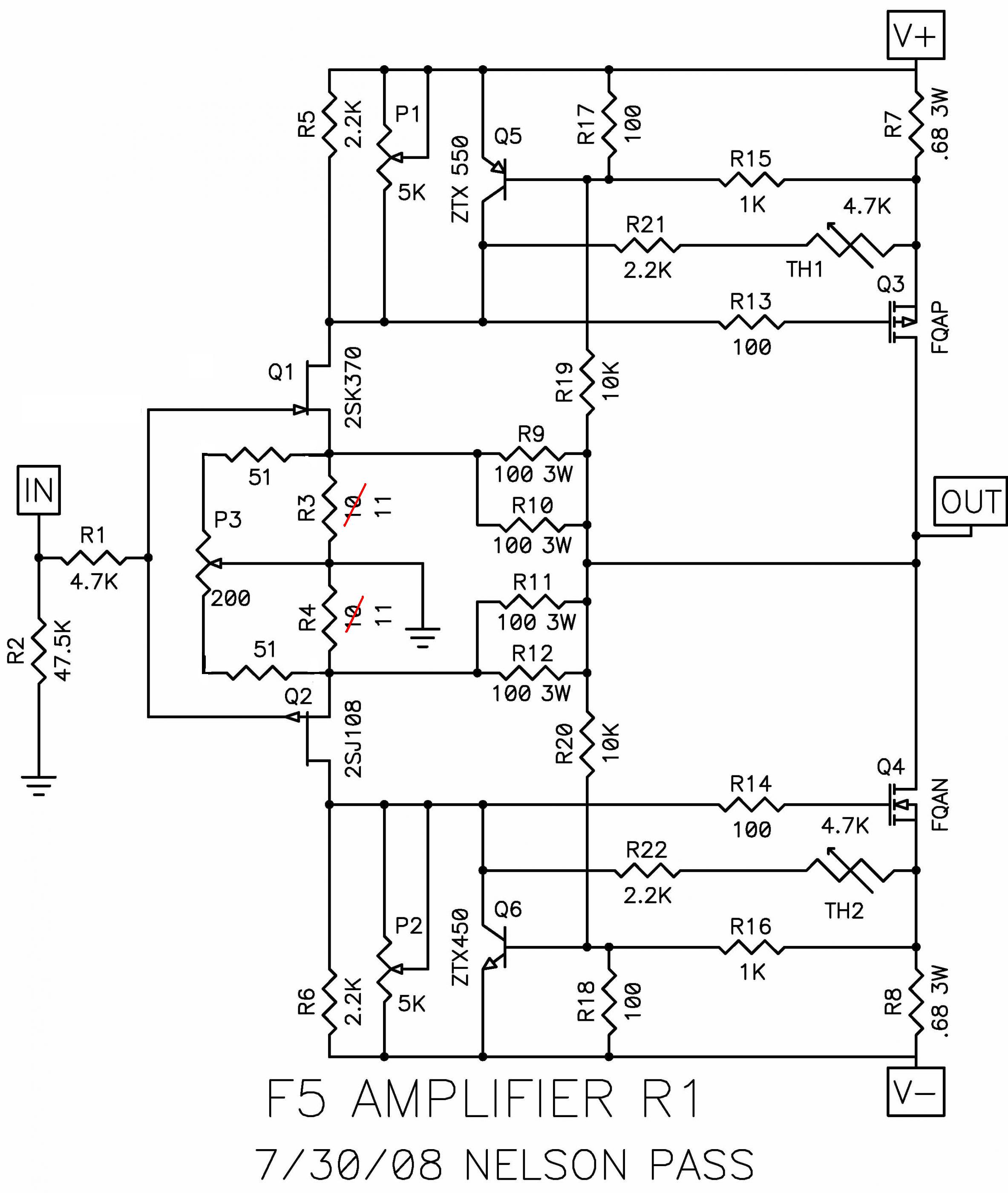

The 51r I suggest is not in the source connection. They still have the 10r as specified.
The bypass using the VR gives adjustment of the 10r downwards and if taken to extreme one could end up with or as the source resistor.
The extra 51r are in the bypass route in series with the adjuster.
Each half of the source resistor sees 10r alone, or 10r//100r ~ 9r1, or 10r//[100r+51r] ~9r4.
The range of adjustment for the three schemes is 10r +-0r0 (10r to 10r), 9r1 +0r4,-9r1, (9r5 to 0r0), 9r4+0.2,-1r1 (9r6 to 8r3).

Add in 51r to the top and bottom legs of P3 before tapping into the Source connections.
This raises the total resistance (of the bypass route) to ~300r and gives an adequate adjustment range for the 10r R3 & R4.
Andrew:
Is this what you're thinking (note that I changed the 10R to 11R):

yes, a simple way to avoid the mis-setting of the adjuster resulting in damaged components.Is this what you're thinking (note that I changed the 10R to 11R):
I quite often insert a slightly higher value resistor where I see that a parallel trimmer could be useful at a later stage. The 11r works in this case, since it gives a fairly close equal adjustment range either side of the standard 10r.

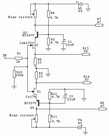

I beliewe SCH was on this tread sorry I can not find exact drawing but I have posted one much similar also on this tread.
I will look for the one I have used and post link asap
The caps I am using and on SCH "lost" are 220uF
I call it "Papa" cascode.
The other one that I am going to try eventualy is the "Borbelly" cascode
