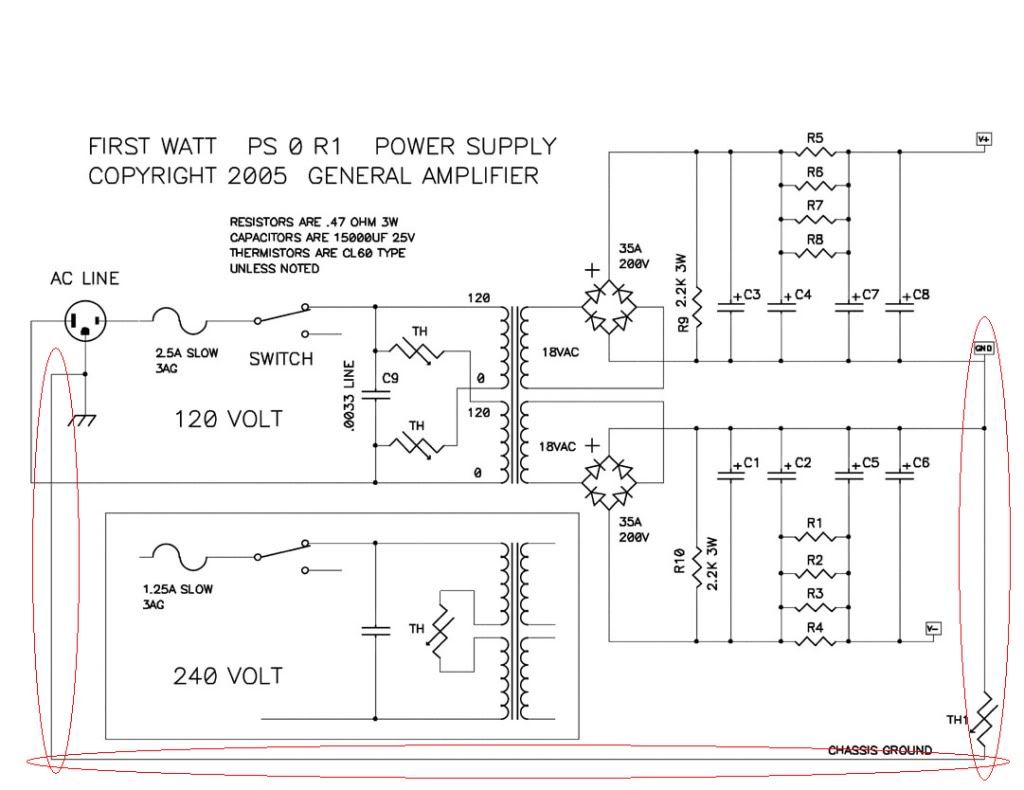

Using this schematic

What would happen if you omitted R9 and R10?

R9 and R10 are "bleeders", strictly there for safety of production workers.
If you test a supply out of circuit, a charge can sit there for quite a while,
and then when you assemble or repair an amplifier there is a hazard.
Safety First. There are few enough DIYers as it is.

Thanks Nelson, thats what I thought but I wanted to be sure. I was going to leave them out because I didn't think I had the right resistors but it turns out that I did have them.

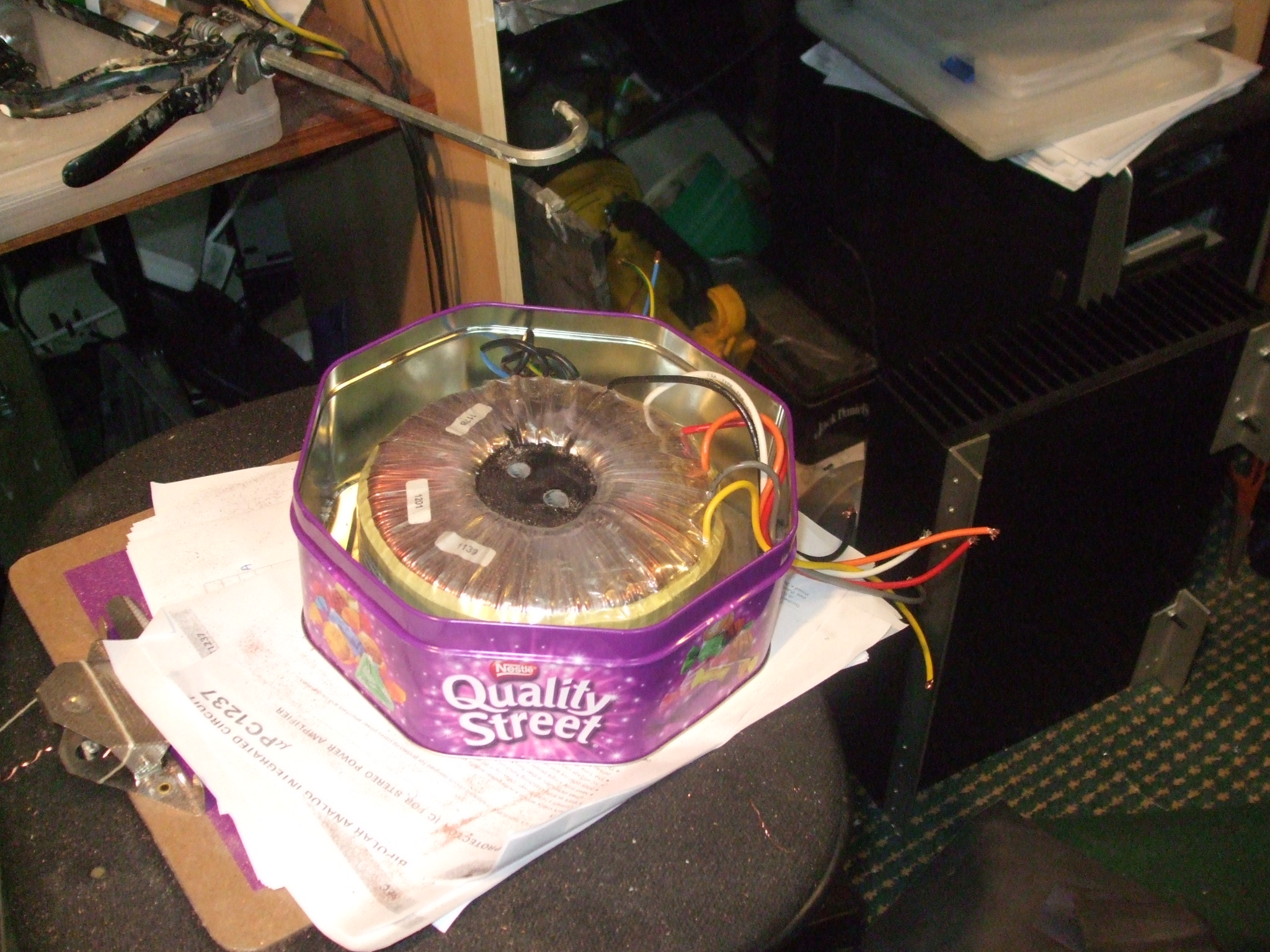

Quick Q: What would happen if you encased a toroid in a copper cover? Would that shield other components from it's EMI?

Sorry to but in I may have quick and easy answer..
I love cooper no mistery about that but is not magnetic so maybe it will be beter to use same othet metal.
Now for the easy answer why not try a biscuit tin ?
Hi Bksabath,I love cooper no mistery about that but is not magnetic so maybe it will be beter to use same othet metal.
You don't necessarily need a magnetic material to shield for electromagnetic fields. You only need a conducting plate or mesh, as long as the holes in it are smaller then the wavelenght of the expected magnetic field. The electromagnetic field induces current or forces in the conductor. Just google for electromagnatic shielding, or "eddy currents". De buzz caused by a transformer, a few posts ago seems more like an earth loop to me, dc on the mains, or harmonic distortion of the mains induced in the toroid. The magnetic field outside a toroid is very,very small due to it's construction!!
Have fun!!
Forgot to mention, don't "short" a toroid with the shielding and it's mounting bolt. If you create a current path through the surrounding shielding and the centre bolt you create a magnetic short-circuit.
BTW strange transformer you have with the two mounting holes, both offcentre... Not the best place to have conducting bolts; offcentre = magnetic flux.
But make sure it's clean inside or the amp may sound a bit crumby
