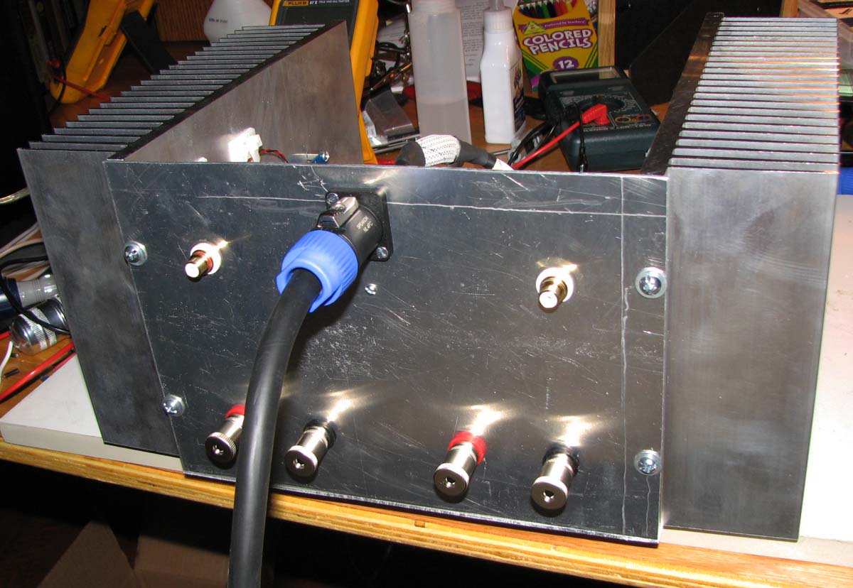

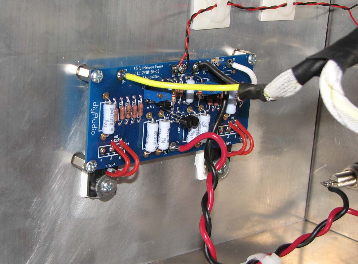

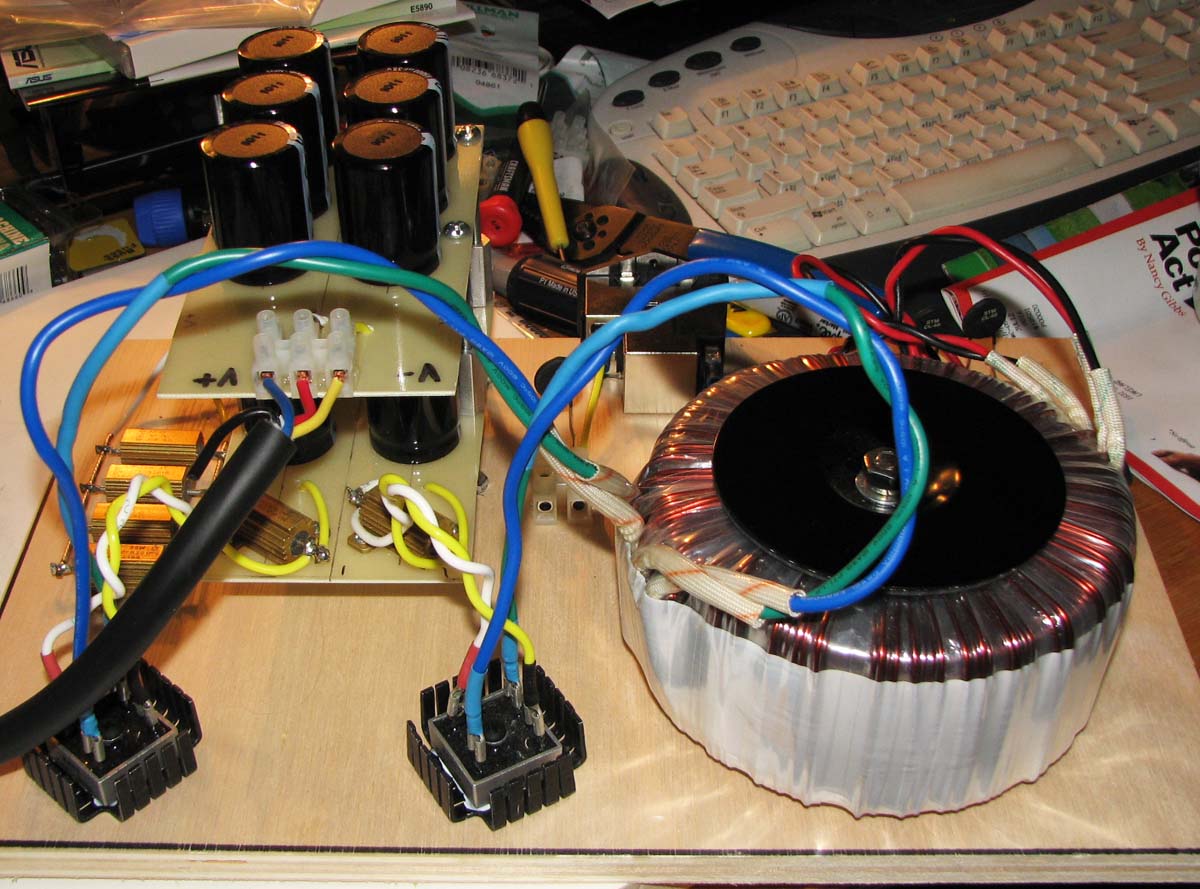

My F5
Here are some pictures of my F5. This is my first ever amp build. It is still not 100% complete, but it is making beautiful music! I wanted to keep the chassis small so the power supply is separate from the amp. Also I will be able to use the power supply for other F amps if I choose to experiment. Thank you to Nelson for providing such nice design. Thank you to all those who have built and posted before me, your pics and experiences have been helpful and inspirational.
Jim
