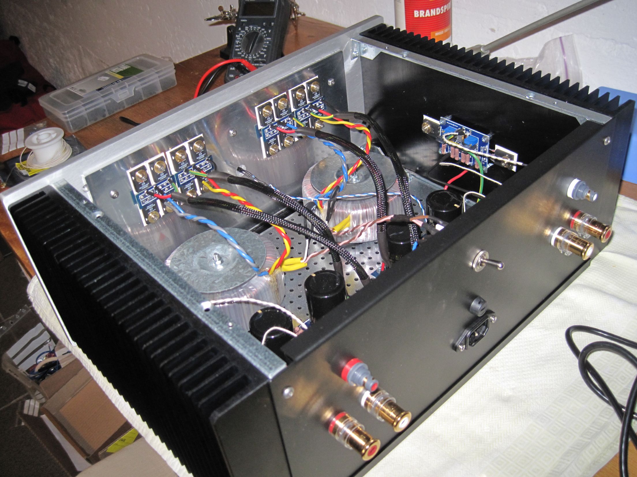

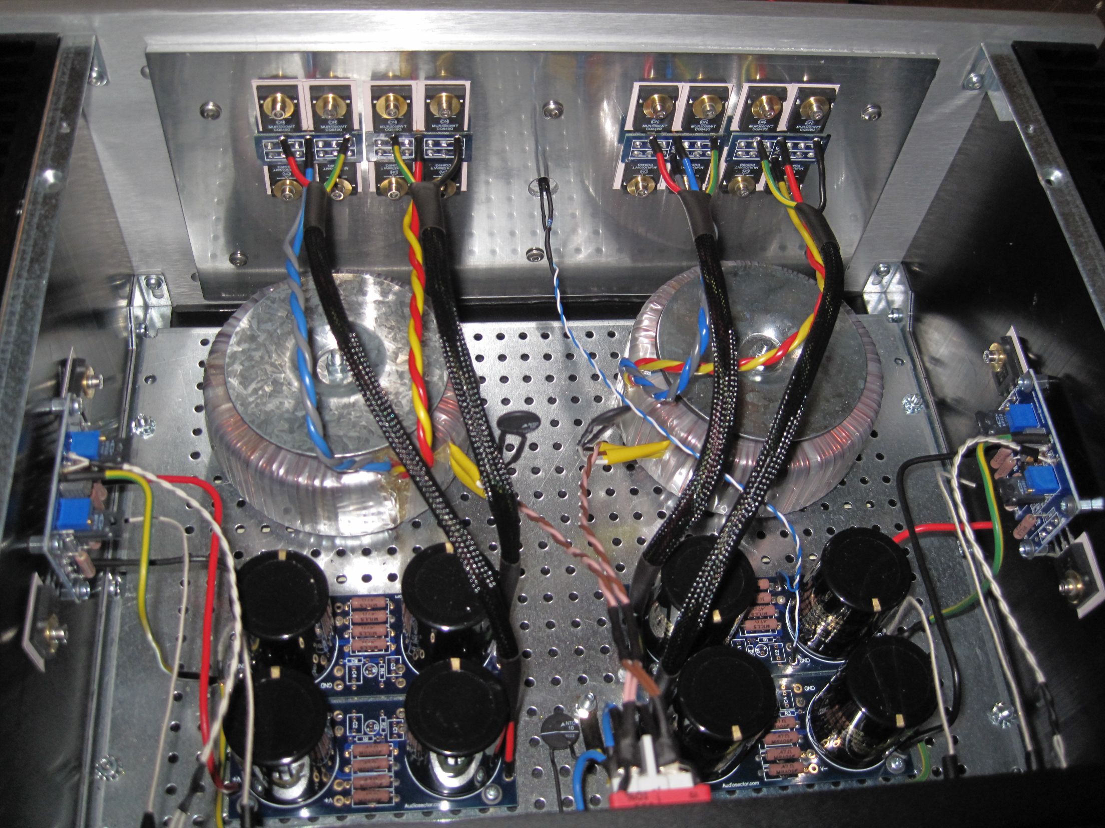

I finished my F5 today and it is working properly. Adjusted now at 90% of target Iqs for a few days to come and than I will test it again. Sound is already great. I am a happy man!! Thanks Peter Daniel for your pcb's and all your advices, h_a for the matched transistors, Zen Mod's very practical initial testing manual an of course mister Pass for giving us the scheme. Enjoying time started. Here are a few pics. :)
great looking amp
Hifi2000 case ? Is It 4U 300 - you got right amount of space for a dual mono
I see that you use Amplimo toroids - what are their spec - what Is your bias, any hum from toroids
regards
