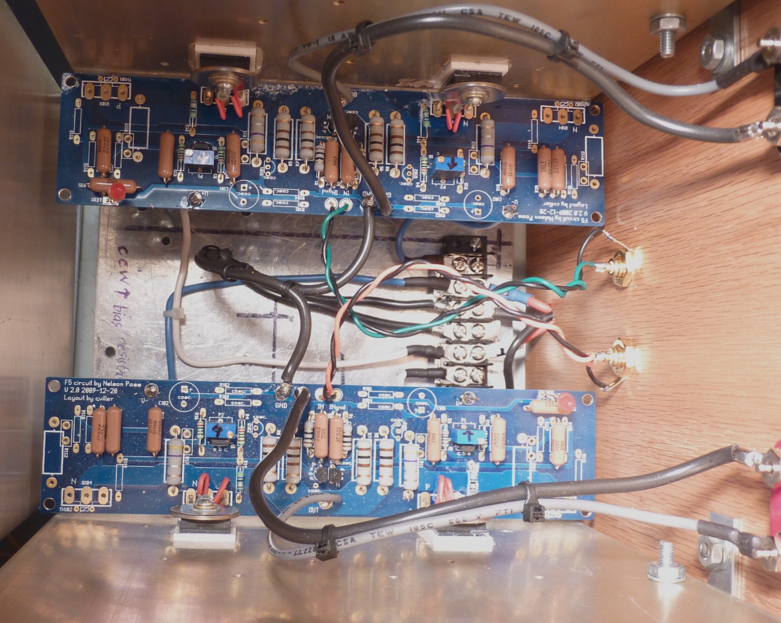

F5 finally (almost) complete. It needs some polishing and a chassis cover, but it is already hooked up to my main system anyway. Best sounding amp I have built and totally quiet.
It is quite revealing (amazed at how many truly terrible recordings there are), but the good ones sound soooo good.

Nicely done! Shouldn't you have the bias resistors mounted slightly higher off the pcb as they generate a considerable amount of heat?

The bias resistors do have a bit of airspace beneath them, but good point-they could be mounted higher.
I used the IRFP240 and 9240.
I was paranoid about over heating, so I bought one of those infrared thermometers.
The mosfets read about 60C after 3 or 4 hours. The sinks are hot but I can easily "hold" onto them for > 10 seconds.

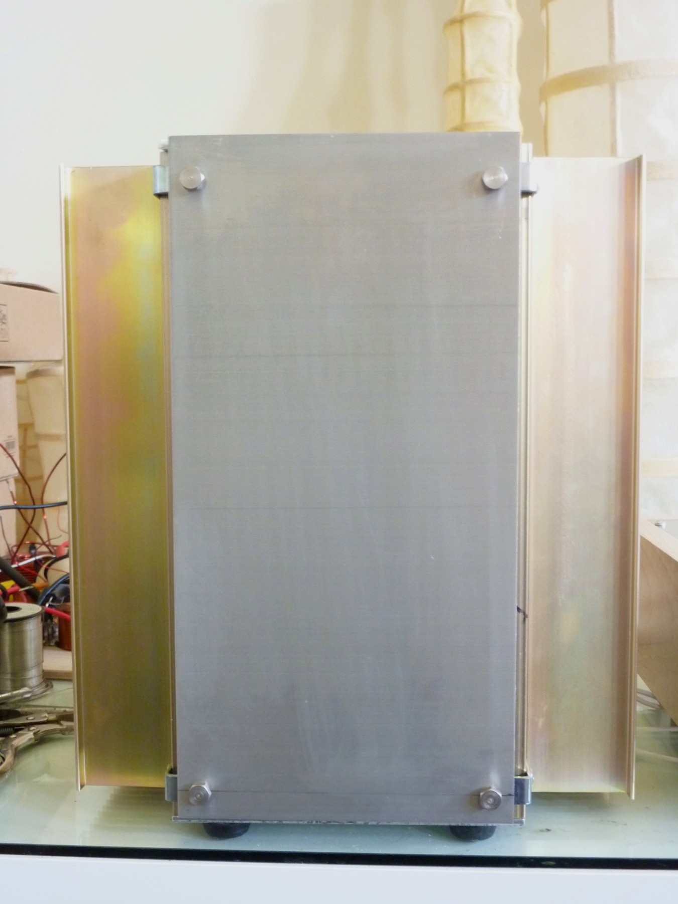

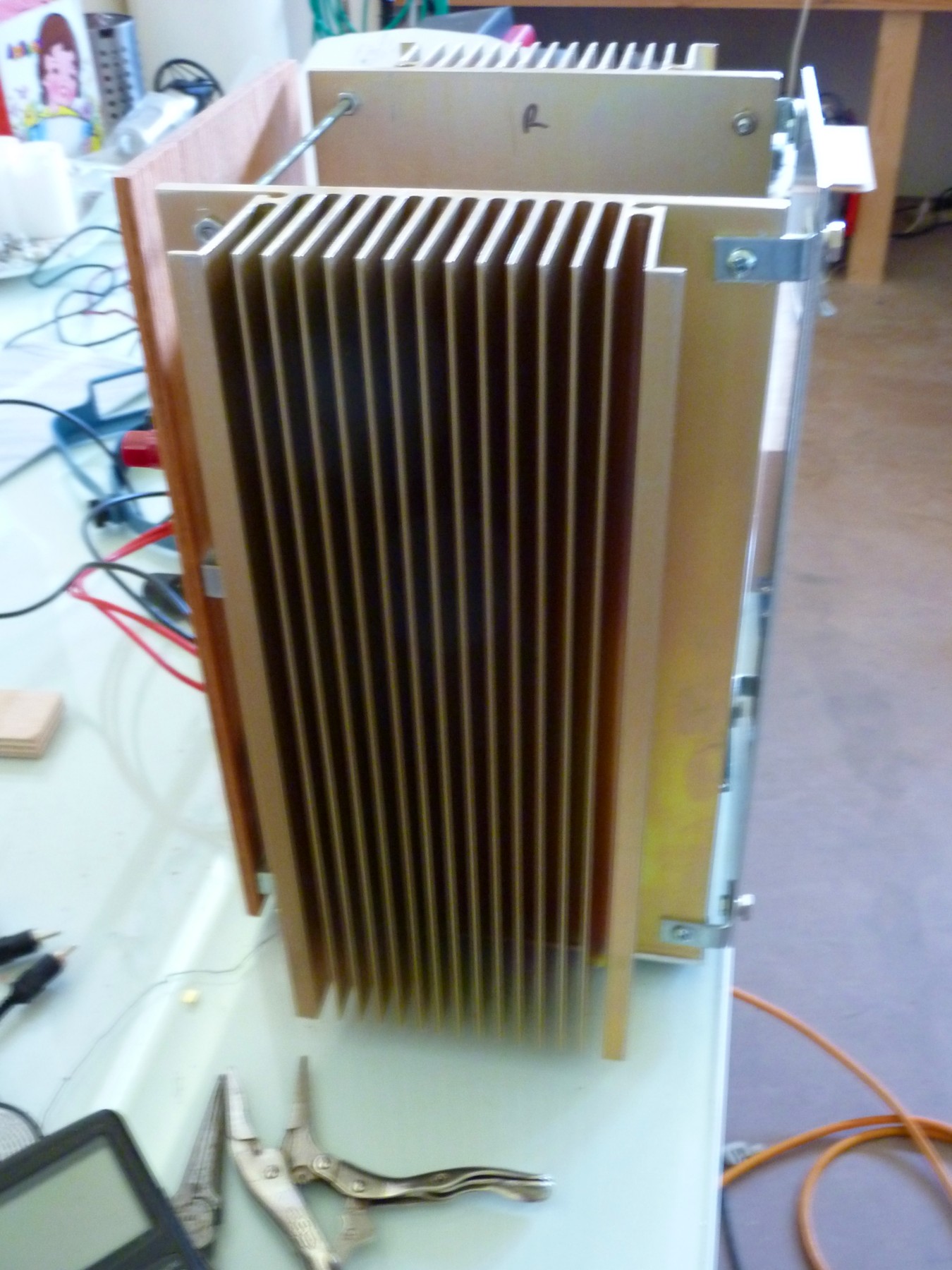

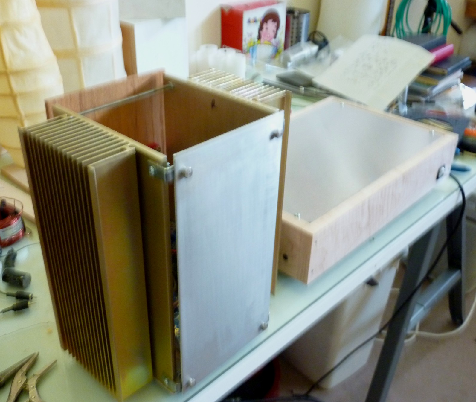

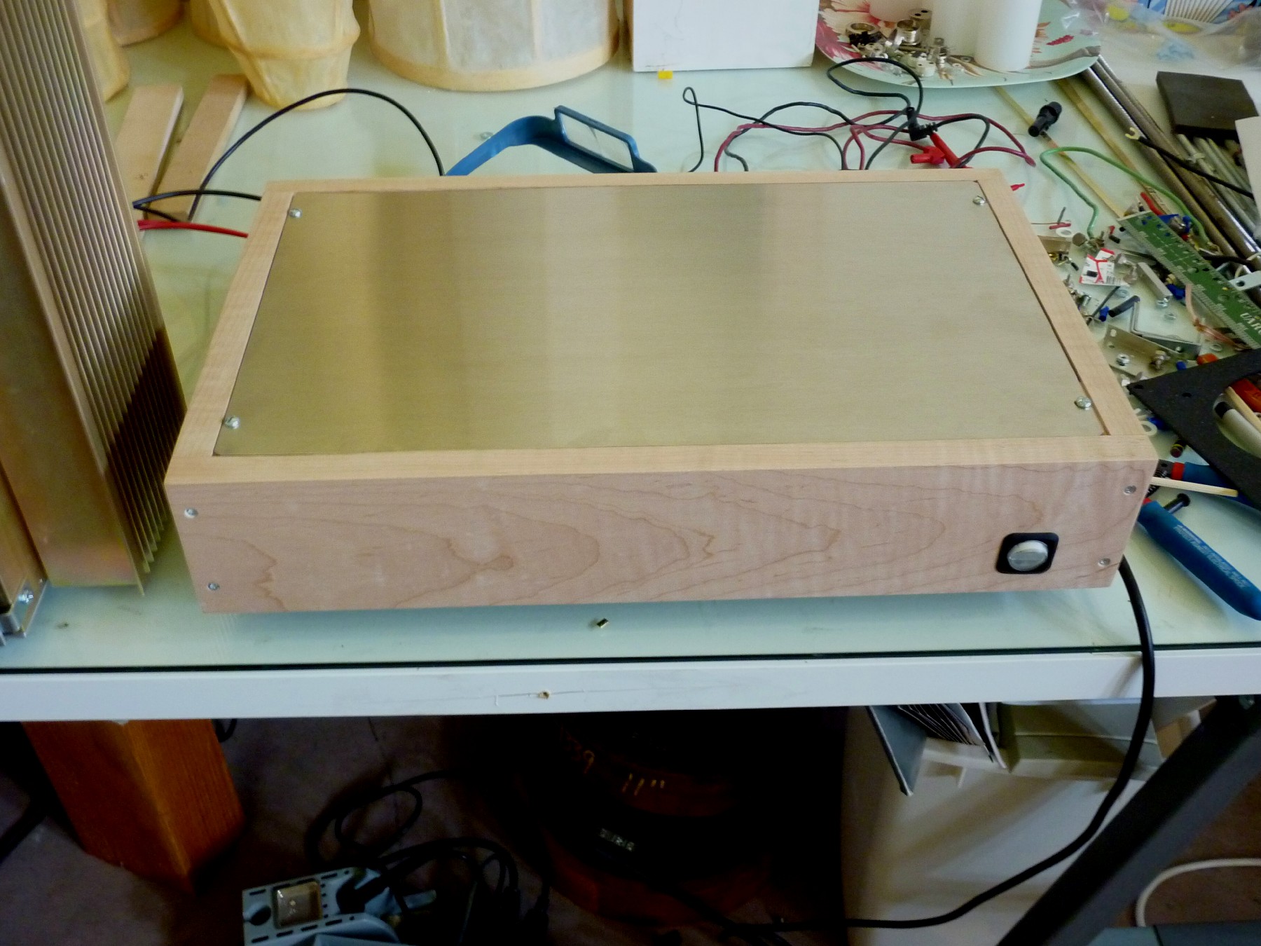

I finally managed to test-run my F5-in-StratosChassis yesterday. It's a basic version F5 with single pair of output FETs, 400VA Antek toroid, 120,000 uF PSU caps, etc. I just did not have access to machine shop so I decided to use the chassis of Odyssey Stratos. Stratos has massive heatsink while it barely gets warm, so I put the Stratos electronics in a small chassis with smaller heatsinks. It runs as it was in the big house.
Now F5-in-Stratos runs warm after a few hours test. The adjustment process was easy. AND, it sounds fantastic!!!
I would like to thank Mr. Pass for sharing such a nice work of art with DIY community.
And I confirm Mr. Pass' suggestion that the bigger the heatsinks the cooler the F5 runs. 😉
