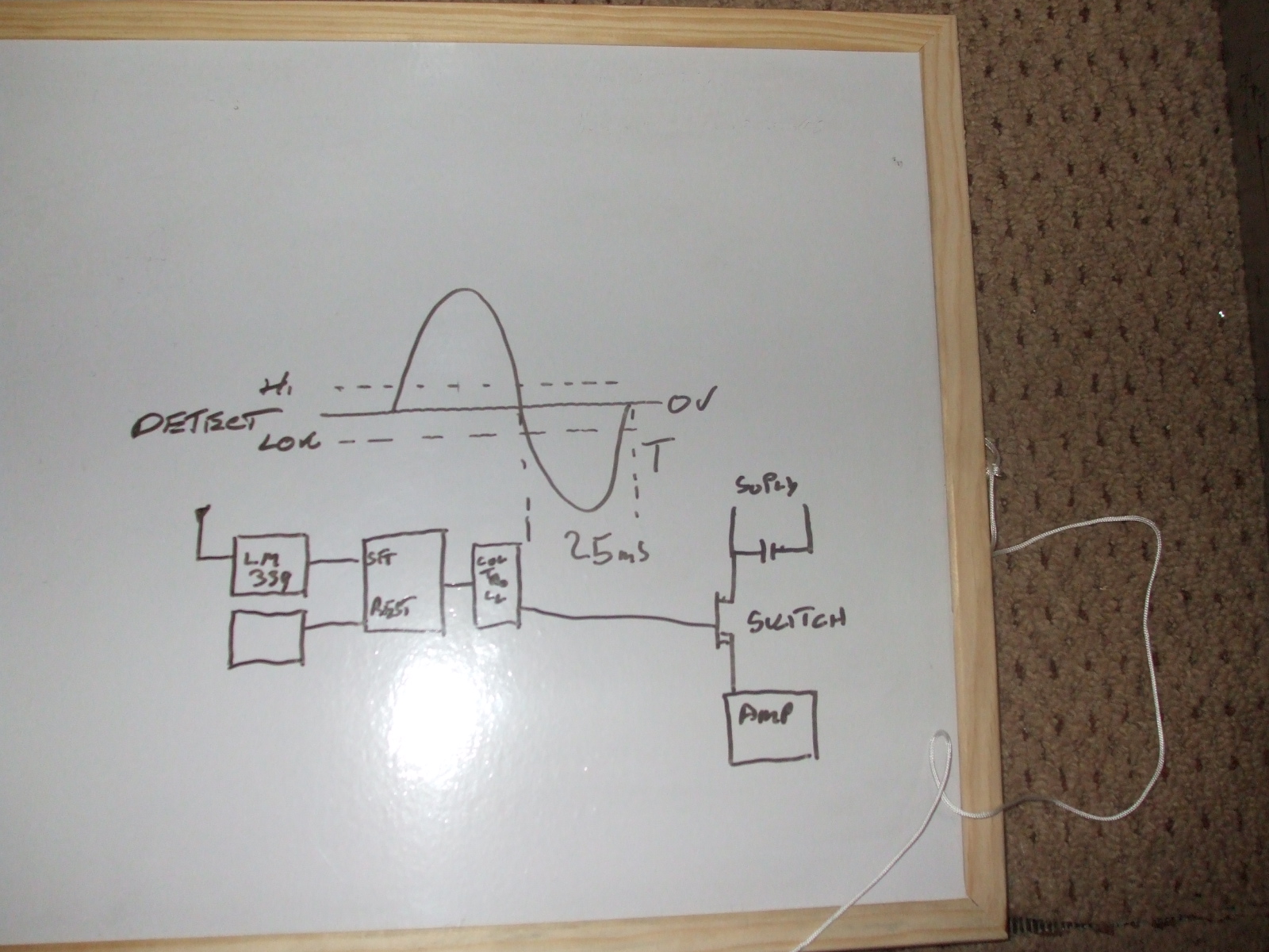

My question was (and I need help with this please) was to use a mosfets as a switch
Question: what is the heat load that this solution would present the mosfets would be in the saturation region so the resistance seen in the circuit is very small would the power dissipated be small also?
I got plenty of spares that did not make it trough the matching so it would be cheaper than a fuse and ancillary and it could sit on a corner of the heat sinks
I had another question relating to the control circuit for the switching mosfets
My thoughts where as the musical signal is made up with waves the voltage at the speakers AC in nature will cross the zero line say for a 10Hz sine wave every 25 milly seconds (is my math correct 1000/(10 X4) )
So I was thinking to use a LM339 to detect the signal voltage rising edge and set a timer a second comparator to detect the falling edge and reset the timer before it reaches the time out of say 50 mS the comparators with inverted functions can perform the reverse on the negative branch of the supply
If the timer’s time outs they latch remove the supply to the gates the mosfets stop conducting speakers safe
It will also work as DC offset protection maybe as the 339 set point can be set to work allowing a tolerable DC offset
So I am big enough now to play with a 555 (maybe) but I don’t think it will be good enough so any one to help with this please.
Tanks

detect the zero crossings.
Send a pulse for each zero crossing.
Use a 555 as a missing pulse detector.
Trigger protection on missing pulse.
However, I would use some kind of "and" to detect the average signal after rectifying. If the average of the rectified signal is >threshold AND missing pulse detector is active then activate protect.
Some music signal is not symmetrical, I suspect this asymmetrical signal could trigger on no zero crossing too often to be tolerated and eventually the user turns off the protection.
Whereas with a zero crossing/missing pulse AND and excessive average DC (either +ve or -ve) the threshold and/or the duration could both be adjusted at build stage to eliminate most, if not all, of the nuisance triggering.

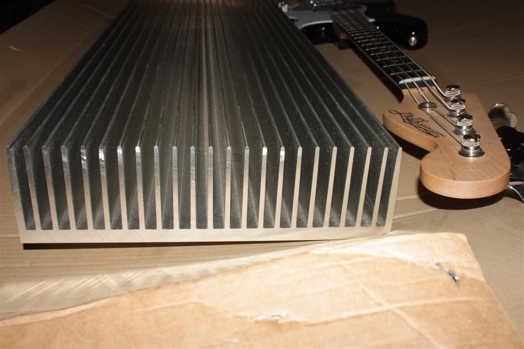

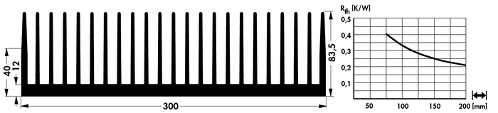

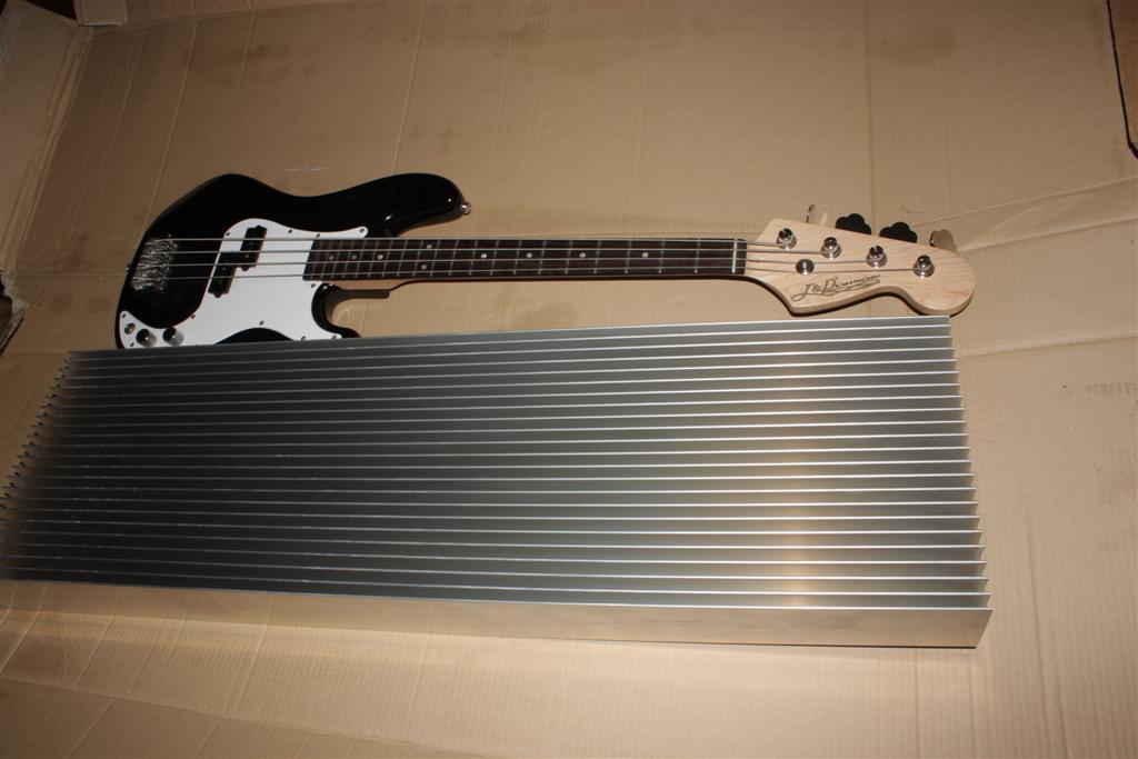

well, yeah a rather smallish kids bass :D
man, this heatsink is so heavy I can barely lift it :eek:
bought in a moment of insanity :$::$::$::hot:

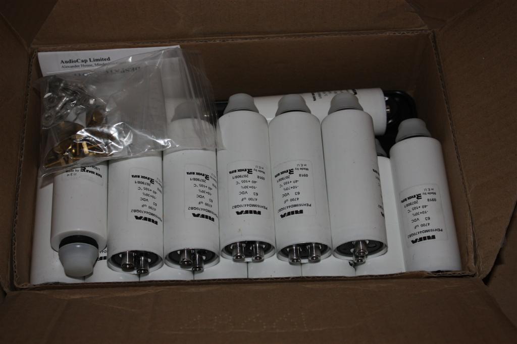

oh, and my supply caps arrived today, yeah

:bawling:Tinitus:bawling:
:redhot:Not fair yours is bigher than mine :redhot:
Only joking realy made up for you
If you don't mind How much?
Going to get them anodised?
If you do make shure you got a hole or fit a bolt where you are shure it will not be seen as they need an electrical contact
Me plonker toke them to the shop in a rush and now they are scrathed just in the wrong place
:cheers:

are those capacitors from the european supplier you told me? I wrote them for a quote but got no reply.
Ex-Moderator R.I.P.
Joined 2005
yes, they are
I think you have to order industrial package to get better prices, or other types than listed
35x95 has case code D, which is "only" 45 pieces
but prices are quite fair as is, so probably wont get much better
and as a bonus, they come with all fittings, like nice brass screws etc
4700uf/63V aint much, but the can size 35x95 fits my planned design perfectly
in 40V range it could have been 10000uf, but no stock
8x 4700uf per mono will have to do
current ratings are compareable
