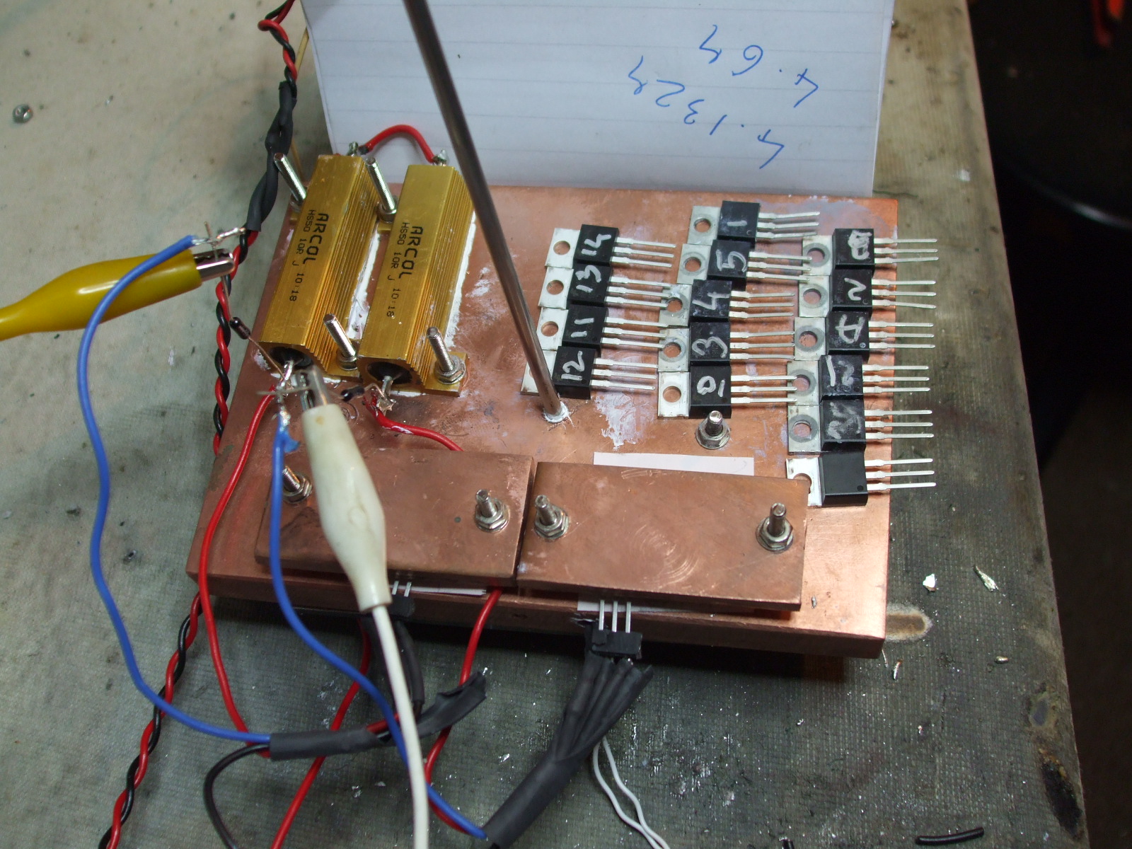

I was looking at mounting options and I am going to try something similar to the picture

Any thoughts on techniques to mount mosfet's to the heat sinks. I used a pressure bar on my gainclones made from aluminum channel. I noticed that others use a washer, would the channel technique work on this amp ok.
Both techniques are good. Look, again, here ESP - Heatsink design and transistor mounting
Notice that you should pay close attention that when you drill your hole in the heatsink you should also countersink a tiny bit to remove the upheaval of the aluminum.
