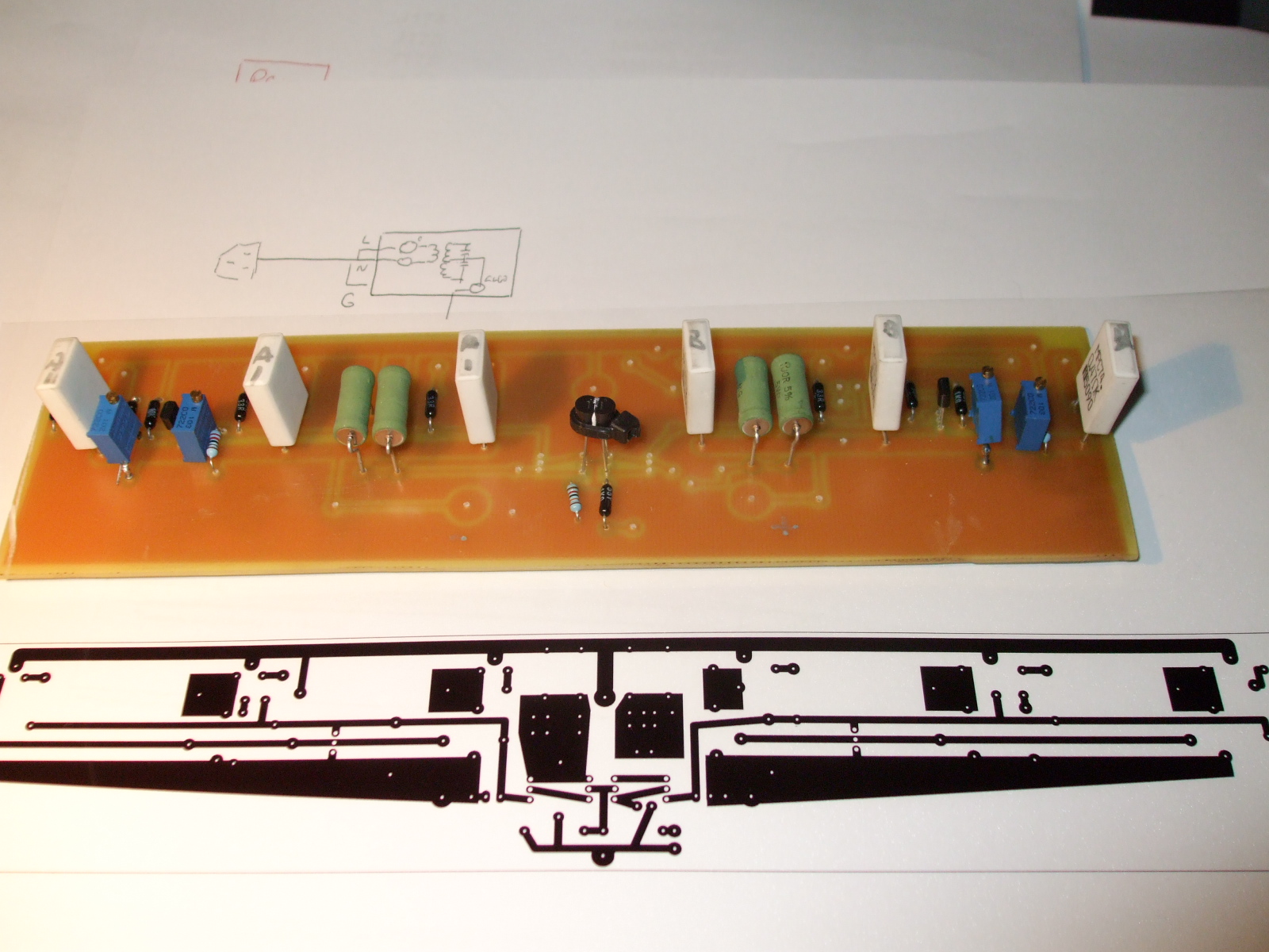

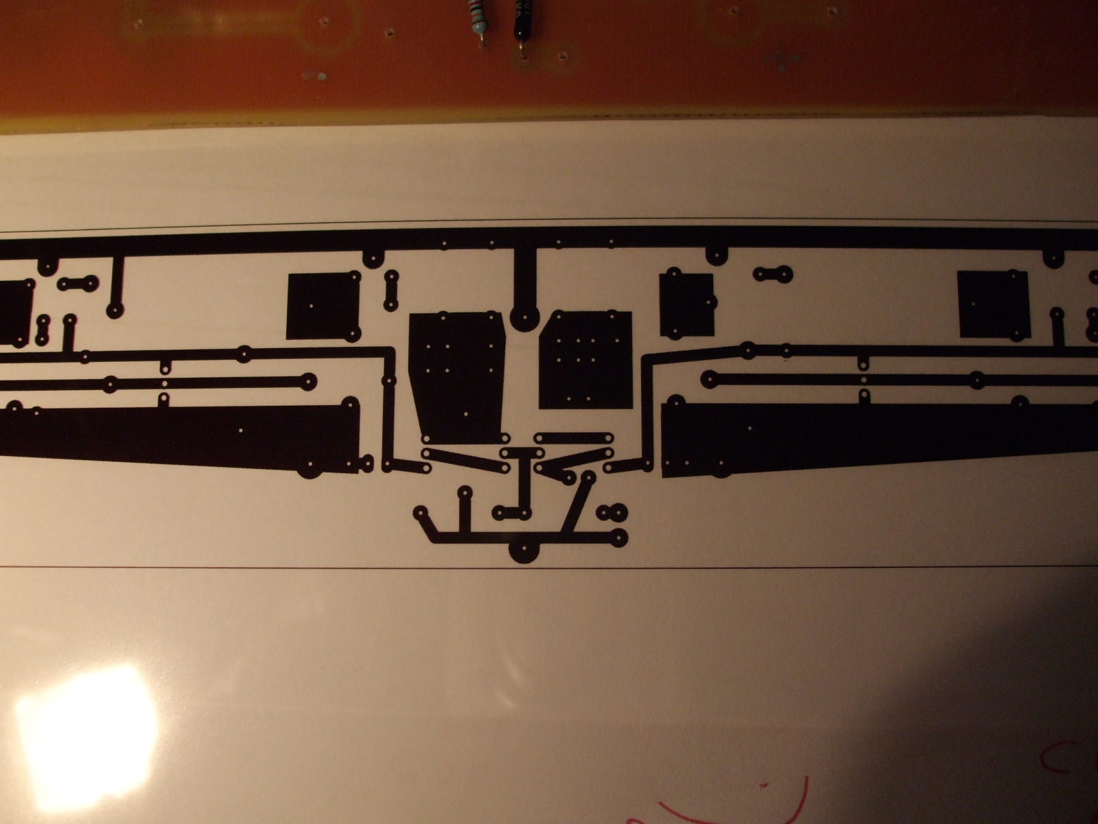

I have enclosed pictures of the mule PCB
and the last version on paper at present.

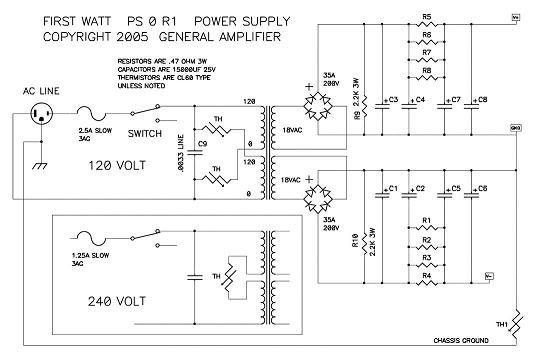

PS 0 R1 PSU RC-calculation
I'm just sitting in front of my recently bought cap bank of 12 RIFA PEH 169KO5330Q (33.000uF each) and thinking about how they fit into the PS0 R1 calculation. I'm not sure about the resistor bank R1 - R8. How are they calculated? And how would it affect R9 and R10?
I tried to find a detailed explanation of the PS 0 R1 schematic but couldn't find it 🙁.
Does anybody have an idea how I can implement my caps and what happens to the resistors?
For background information, I'm going to build a 2 channel supply using 1 toroid.
Thx,
Mallard
Thx,
Mallard
For the F5 you probably need only 4 of the 33,000 uf caps and leave R1-R8 the same. R9 and R10 too.
