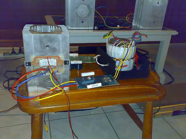

My F5 is singing!
Thanks Mr. Pass for sharing this wonderful amp design. It is by far the best sounding amp of mine.
I have one question. I managed to adjust the DC offset to 0V, but the voltages across R11 and R12 differed by about 0.04v. Is this acceptable? If I try to adjust the voltages to be the same the DC offset would be higher. Which is more important - the DC offset or the voltages across R11 and R12?
Despite that, the amp still sounds very sweet.

I like your heatsink, no problem dissipating the class A heat generated by this Amp.
chinsettawong said:
My F5 is singing!
Am I seeing this right? Are the Fet's on the thin part of the heatsink?
If so, than it's better to turn the PCB 90 degree CW or CCW so the powerfet's can dissipate the heat properly.
