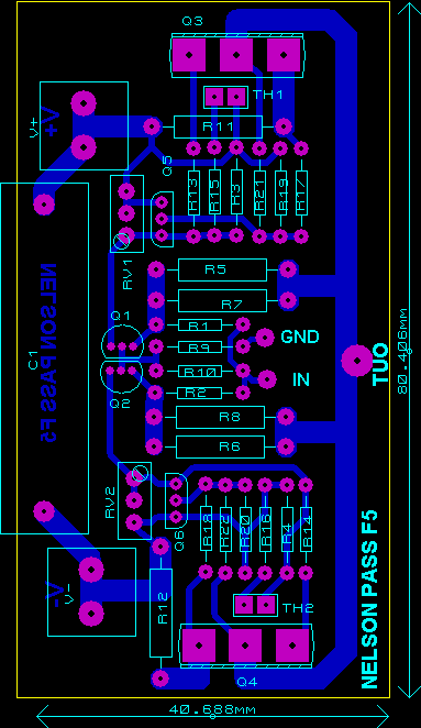

Hi Goffe,
If you want Q1 and Q2 placed face-to face, than the D and S of Q2 should trade places.
The IN and GND points too.
R1 and R2 should be at least 1W.
ZTX 450/550 have Collector as the middle pin.
What's C1 ?
Keep working, your PCB is getting better and better !
I think ZTX 450 and 550 has BASE at the middle pin ;
With the printed face in front of you ,the left pin is collector .

Q2,IN, GND you are right juma, thanks!
My mistake
C1 are bipass cap from V+ to V-(maybe not necessary)
Why?
8 mA in each resistor squared * 10 ohms

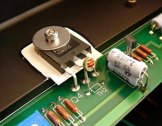

Did anybody noticed that in the close up picture in post #926 at the top of this page Nelson added a 2.4 ohms resistor in parallel to the 0.47 ohm source resistor of the Nch mosfet (Q4)?
Moreover, the gate resistor seems to be 150 ohms in lieu of 47 ohms indicated in the published schematics. (Assuming that the left hand resistor close to the gate is R14)
A special tweaking or........???
I'm sure the Master tweaks all of the production units.
R1 andR2 are also part of the 60 ohm feedback loop, try that with 20V across it.

Yes, the base is in the middle, but with the printed face in front of you , the right pin is collector (picture from datasheet attached)
massimo said:
Why?
You forget the current that is coming from output through 100 Ohms / 3 W resistors.

It doesn't look Nelson has used other than Dale RN55 resistors at the input of the amp reviewed by 6moons, anyway. (the two + two resistors close to the JFets, iI mean.)
Even in the article, a part from the blue Pana 3W, he suggested to use 1/2 W resistors throughout.
