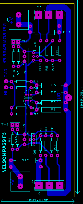

JUMA,
What software did you work with?
That is a really nice layout.
Anybody got any recommendations on an Etching kit in the states?;otherwise, I will wire this Point to point.

Re: JUMA PCB
It's Sprint-Layout 5.0 (http://www.abacom-online.de/uk/html/sprint-layout.html) - 40 EUR only 🙂

Re: JUMA PCB
Mike, you don't need t no itching kit 😀 read this:
http://www.diyaudio.com/forums/showthread.php?postid=1073081#post1073081

Re: Re: JUMA PCB
Read the thread which Juma cites -- you can get 2% H2O2 as an antiseptic in the drug store, and muriatic acid (for cleaning brick at the hardware store).

JUMA post
Juma, thanks,
Okay,
So I will try to spell it out for myself..
so your method is to tape on printout for drilling holes (got to find real tiny bits, hmmm)
Then I suppose take this printout off and then handraw the circuit with a marker of the copper PCB sheet. What type of water proof marker should I use, not a Shapie permanent marker I suppose? More like a crayon? 😕
Add into Hydrogen peroxide and Muratic acid solution.
Then add flux, and then solder the traces on I would assume with some real wide Solder with a wide tip iron. Sounds like cooking...
It will then look like my old Hafler DH-200 boards.
Did I misunderstand something?
I believe that a Sharpie type marker is exactly what they use..
After, you scrub it off using I dunno - laquer thinnner?
I use any black-color oil paint.
I use the toothpick for the drawing.
Finally, I rub off the paint, using a hard luffa...

Sharpie works fine. Clean the board with a brillo pad and then use a degreaser . Draw your pattern with the sharpie and etch with 2 parts peroxide and 1 part muriatic. Be careful with the mixture ..I do the etching outdoors. When etch is complete wash board well and drill holes. Then I coat the traces with flux from flux pen from mouser and let flux dry. Then I flow solder on the traces.
I have also drilled holes first but that requires laying traces out twice.
The reason for flux solder treatment is to cover pinholes after etch. The sharpie is not the greatest mask. You might do better with Babo's oil paint .I imagine a tube of artist's oil would do the job.

Home-made PCBs
Guys, this is how I do it:
- You print on paper the published picture (it's a bottom view of the PCB - take care with dimensions)
- Scotch tape the piece of paper over the cleaned copper surface
- Drill the holes
- Clean it again (acetone, nail polish remover...)
- Use the water-resistant permanent marker (Staedtler, Faber-Castel...), with a, preferably, hard tip sized 1 mm or smaller to draw the traces exactly like they are on the paper you used for drilling
- Now you etch it like described ( H2O2 + HCl )
- Clean the marker traces with acetone
- Cover the copper traces with non-acid soldering grease (that's the name used here - I don't know the name of US equivalent - it's a greasy substance that makes soldering easier and quicker)
- Use a small quantity of soldering tin to cover the traces
- Clean the grease (alcohol, acetone, dish-washing detergent...)
Your PCB is ready. The success mainly depends on how clean the copper is before the drawing - don't touch it with your fingers.
One more thing: No brillo-pads or similar stuff - no abrasive materials - we don't want to mechanically hurt the copper traces. Acetone on cotton-ball and detergent on soft sponge will do the cleaning perfectly.
