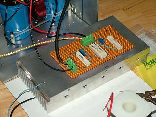

One dead bug channel of F5 is up and running.
Not having the correct devices on hand, I had to use some old junk-fets I had laying around, in this case a 2n4416A and a 2n5116. They had Idss's of 9ma and 12ma, closest match to the recommended I had on hand.
A 10khz square wave shows no overshoot, and looks very square.
Yes, that is speaker wire you see attached. After letting it warm up for about 40 minutes, it seemed very stable, so I hooked it up to a speaker and listened to one channel of Dido.
First impression was that the F5 does an amazing job of reproducing every aspect of her voice -- which is simply amazing.
Very detailed amp-I can't wait to do the other channel. (even though it is surely nowhere near one built with the right j-fets)
JJ

Too late to take a picture, and I want to sit down with the XYL and watch some TV (it's almost 11 p.m. here in the People's Republic of New Jersey), but using separate gate input resistors has had a most salutory effect.
jupiterjune said:Not having the correct devices on hand, I had to use some old junk-fets I had laying around, in this case a 2n4416A and a 2n5116. They had Idss's of 9ma and 12ma, closest match to the recommended I had on hand.
...(even though it is surely nowhere near one built with the right j-fets)
That the ticket. I'm sure that those JFETs work fine although they
do look to have a lower transconductance than the 2SK170/2SJ74.
