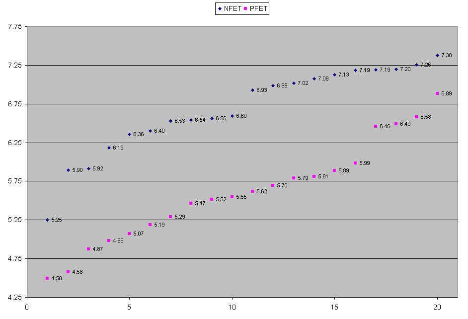

I finally got my FETs in and I am wondering how you guys go about matching (or if you bother). I have 20 of each JFETs and 6 of each MOSFET. I read somewhere that there were many more needed (1000 comes to mind) to get a good match. Please reply back with methods, circuits, links etc. so that I can compare what I've read to experienced guys. There's a lot of information out there for a newbie.
Thanks,
Everett
The Jfets are tested for static Idss... the current through them with zero bias on the gate... although since you are maybe more interested in a relative match (a pair of each P & N?) as long as the test rig is the same, the match is ok.
You will likely not get very very good matches with a batch of 20, especially if that is 10 Pch and 10 Nch... but you can still see what is going to be closest to what...
The test is simple enough and really is just a voltage in series with the jfet and a means to measure the current. The specific circuit ought to be online in all sorts of places, including in the Toshiba, Siliconix and other data books...
The Mosfets require a bit more work... you need a similar set up, but with a variable means of adjusting bias voltage, measuring current and supplying some voltage with current behind it.

Thanks Bear, I ended up doing Vds=10 and a 1 Ohm source resistor. Here are the results after 80 total measurements (average of two per FET)

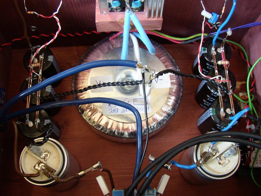

Has anyone used transformers from Toroidy.pl. I seem to remember that someone said they were going to try them and post results but I havent come across any more posts. I still have another 100 pages to read so maybe I havent found his results yet.
I used the 300VA audio version in my monoblocks. I think they are very interesting as quality/price ratio.
Speak to Tomasz at Toroidy, he's very friendly.

near Lincoln your tolerance on mains supply voltage is 216Vac to 254Vac. The lower limit will probably never be reached other than during a fault situation. It used to be 226Vac and you can reasonably expect your range to be between 226Vac and 254Vac
Adding a few turns to the primary winding will make a difference particularly since the combination of high input voltage and low mains frequency takes all universal transformers right to the edge of the production/design compromises.
Better would be a tapping at 230Vac & 240Vac.
Best of all would be one primary at 120/125Vac and the second primary at 115/125Vac.
This would allow you to select any voltage from 235Vac to 250Vac in 5V increments.
The two extra taps will probably cost more, but may be worth it to you.
Note that none of these options allow use in a 110/120Vac region.
Thanks for the reply Andrew. I'll go for the straight 240V primary as I used to use some potted Avel Lindberg transformers on Pass A40's years ago and they were as silent as the grave. I still have them but unfortunately at 22-0-22 secs they are no good for the F5 as I'd like to keep the power supply as simple as possible.
Regards Keith
