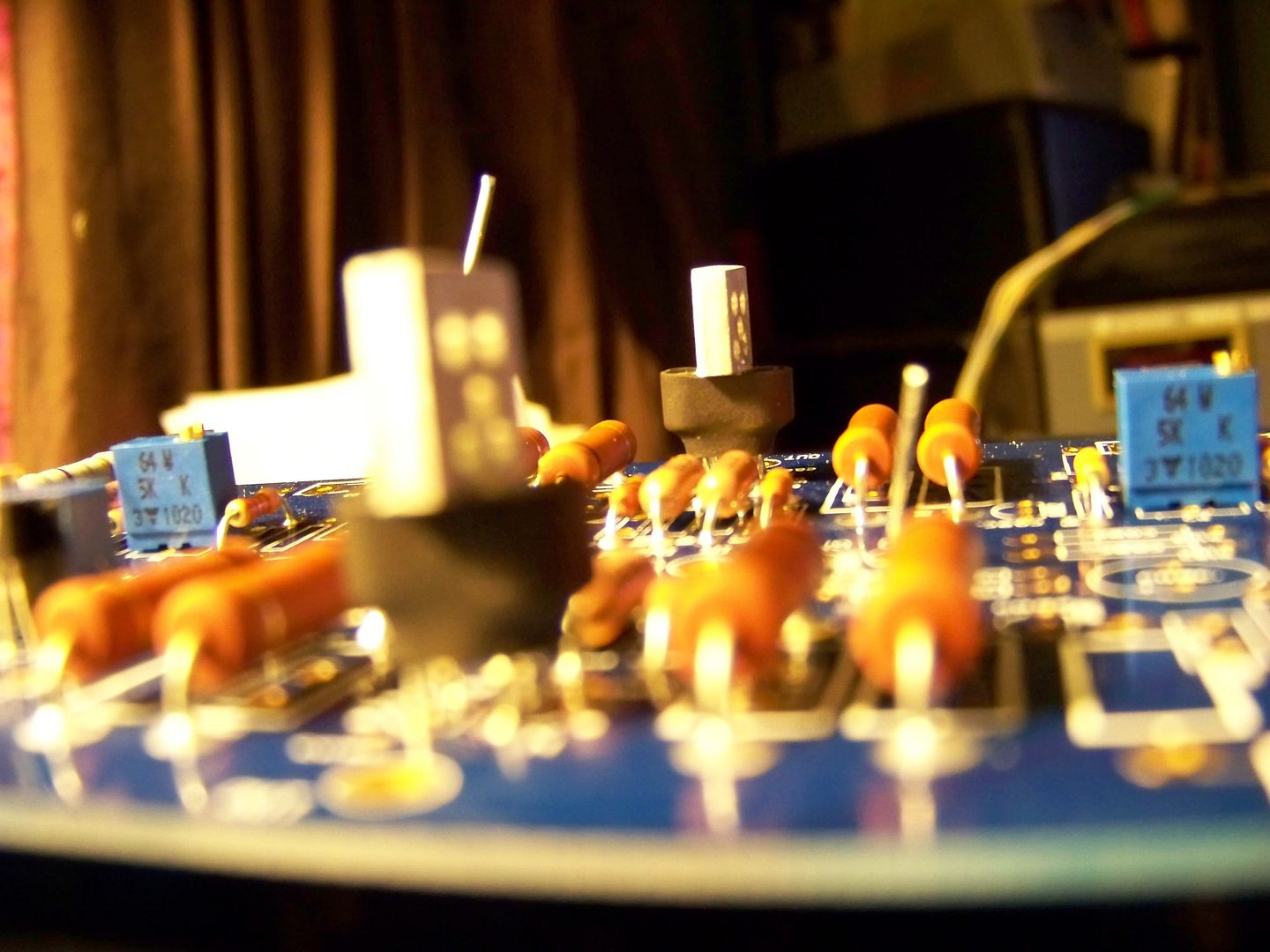

JFET thermal coupling
I finally got my F5 boards populated and I thought I'd share a pic of the thermal coupling fin I made for the JFETs. It's just a little chunk of aluminum I made a fat T shape out of with a small hacksaw. After sanding, filing, and drilling this is the result. I used a bit of shrink tubing and thermal paste as well to finish them off. I'm hoping that these will help add some thermal mass to the first stage.
