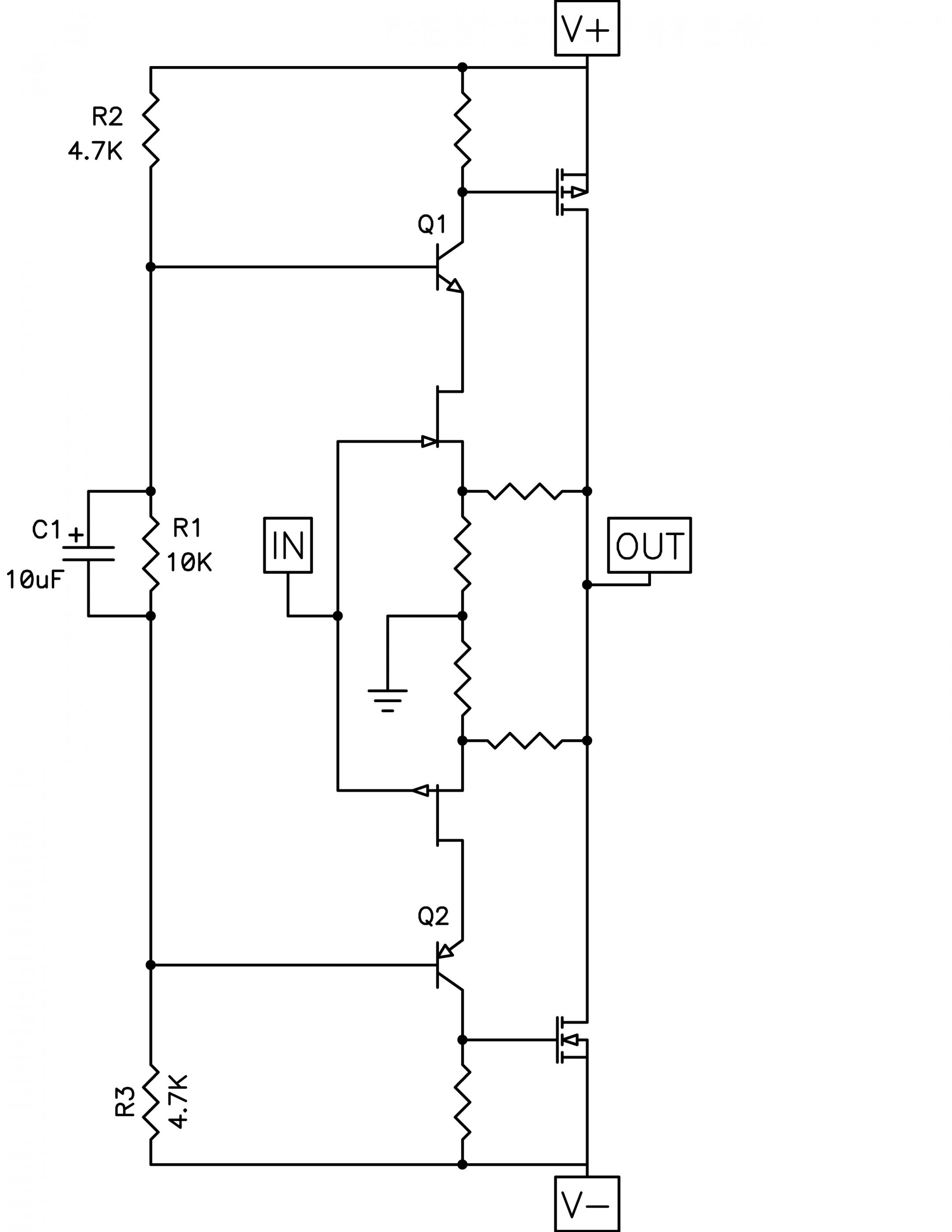

It's probably easier to cascode the Jfets with some bipolar
transistors.
How?
