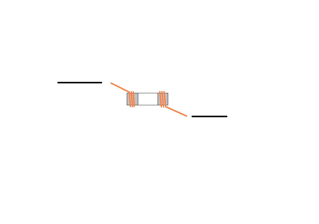

Maybe better think about your fuse holder![]()
Skip the fuse holder; solder the end plates directly to the switch and wire
Just wipe the standard fuses and the f/holder contacts with a good contact grease and just "wax lyrical" (talk about) all those $30+ silver fuses and the even more expensive holders - if you want to spend money at the ac inlet, better quality IEC plugs/socket with good quality reasonable cost power cable is a much better investment (IMO, naturally)
I do suggest you also clean/grease all these ac bits regularly, when you do the RCA plugs/sockets (yes, even the silver ones)
But applying your efforts, and $s, on the power supplies themselves (components and design) is still the best "bang for your buck" that you'll ever get.
