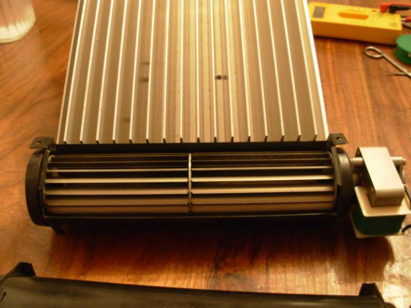

Hey chchyong89,
Nice heatpipes. I don't have any experience with those. But, I have a question -- do you have them upside down in your pic? Don't they need to have the fins on top? I may be wrong here. But, I thought that there is a liquid inside the pipes which changes state and goes to a gas when it heats. The gas then moves up toward the fins and cools back into a liquid and falls back down toward the device and repeats the cycle. Isn't that how they are supposed to function? Or, am I incorrect here?

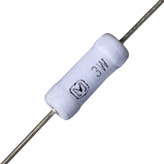

alternative could be this 5w foil resistor, and cheap too, values from 0R1-1R0
