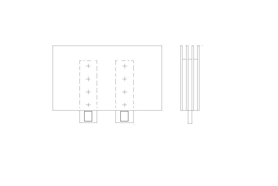

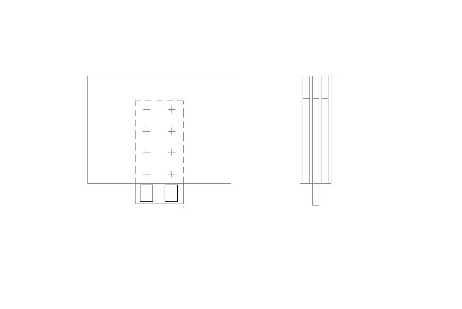

Like this maybe

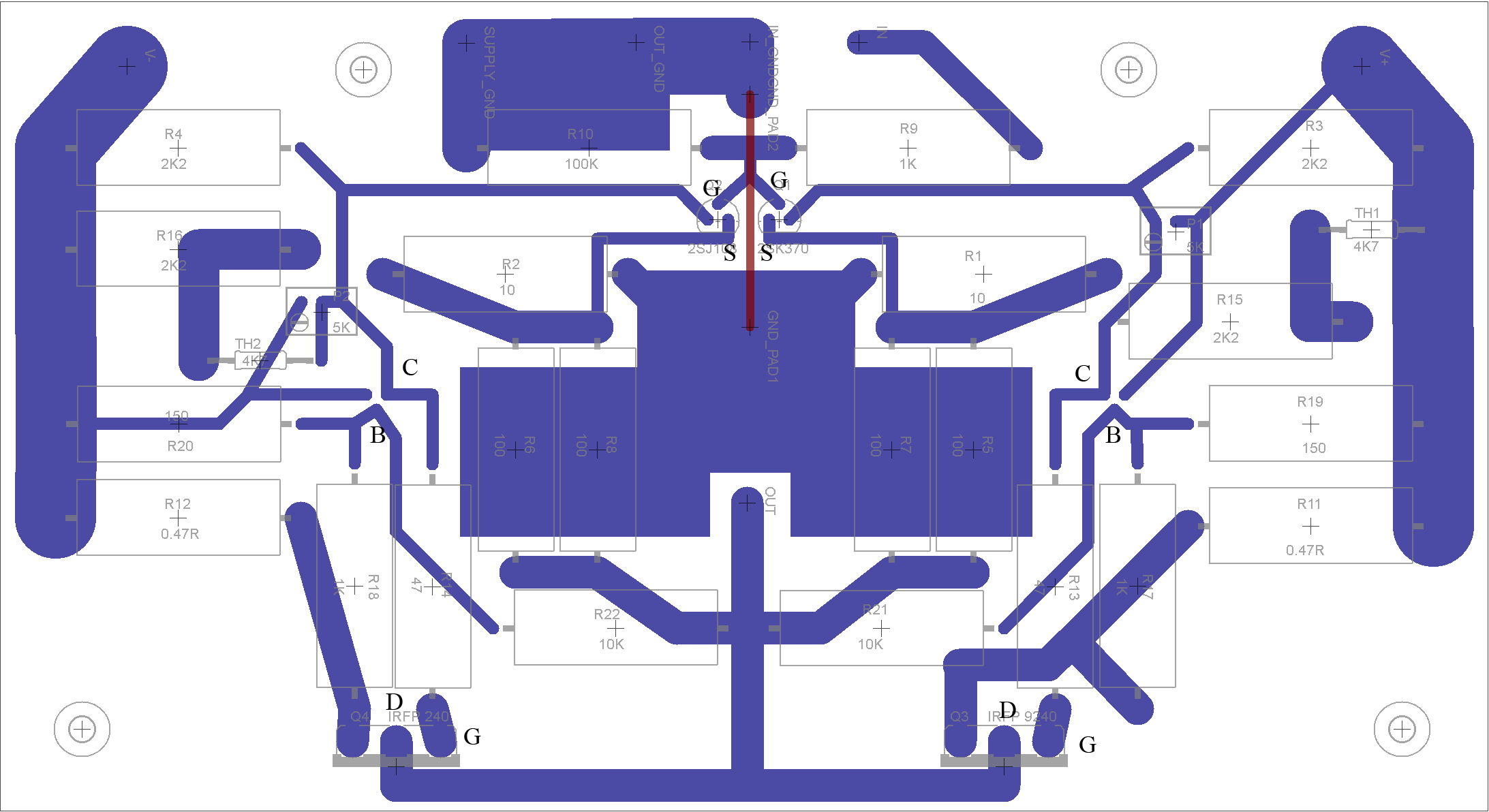

I make layout for my F5 board, please help me to check this layout, assuring there is no faulty on it. I havent edit the SK370 layout, the correct one is reverse it. Also about the thermistor, its better if placed near output transistor.
Thanks before

i am wondering, there is +24 -24 and Gnd after CRC, the picture shown above don't connect anything to Gnd after crc, is it no need to connect the Gnd from crc to the Gnd of F5 board??
here is mine.
i have a bunch of stupid questions, hope you all don't mind
my transformer used is E transformer which lead out 18 0 0 18, in before i am too stupid to connect both 0 0 together and into the Gnd of the CRC, and smoke coming out from the wires :O so end up i don't connect anything to both 0. Or is it wrong anything?
Psu (CRC) ground is connected to F5 board.(Green wire)
Generally, the outputs of a transformer are 0-18-0-18 and not 18-0-0-18.
To check, connect the two presumed 0 together and then measure voltage across the two 18. You should read 36v. As long as you do not short a winding, there is no risk.
post7766.
are the two double insulated wires coming from the transformer, the mains input?
If yes, then they should be double insulated all the way back to the mains fuse and to the IEC input socket.
Twist all the wire pairs into and out of the transformer to minimise the radiated fields.
