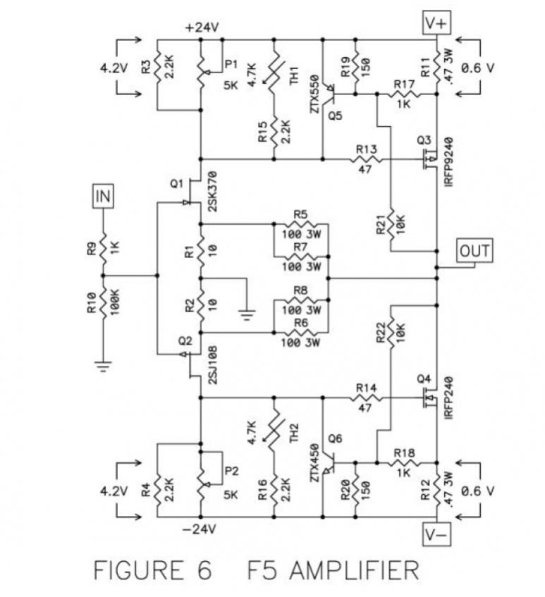

F5 power amplifier

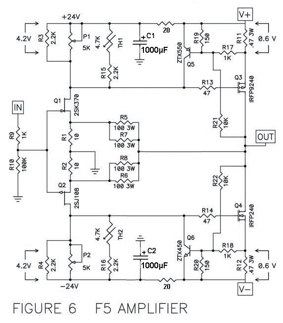

what do you think about extra decoupling for the jfets like this?:scratch1:
"decoupling"
Are you talking about the same
The suggested looks just like a "small" onboard 1000uf supply cap to me
Will that be fit fore classA? one reason I may have my doubts about such
Without knowing enough about, I would rather try and have the main supply caps closer to amp curcuit
"more stable" ? maybe best not say that 😀
Well that is what decoupling is. But it is true that NP has expressed strong opinions against decoupling on the F5.
I would assume that this is highly dependent on the actual implementation, but since decoupling can give you better high frequency performance at best, I think it is very much irrelevant for this amp, unless you as jack use it in the ham bands.
Oh, I thought "decoupling" was about small filmcaps
But ok, I see it now, theres a small 20ohm resistor added, in the suggested schematic
I my "common logic" and understanding of english, "DEcoupling is the resistor, more than the exstra cap, I guess
Well, I admit to have suggested similar a while back, to have seperate supply fore jfet
And it was explained to me that jfet and outputs are so very closely coupled, so that any differential imbalance from supply may cause severe problems
