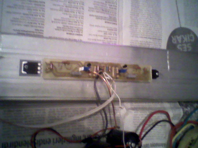

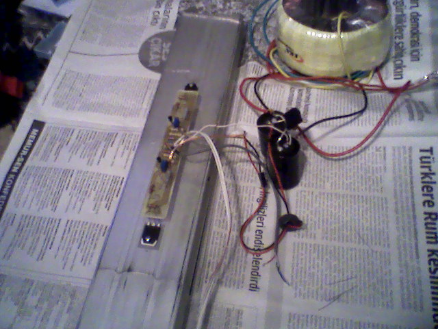

hi.I built an F5 for trying.I didnt use ztx transistors and thermistor for now.DC offset is 1v when bias is near zero and when i am turning the pots I see 0.7 volts on 0.47r resistors and the offset is 700mv.. the 0.47 resistors are getting too hot when i am trying to lower the offset.I connected it to speaker and played music.It works but not properly I think.Did i burned the p channel mosfet?.Does it play with one mosfet ?What can i do ?

You have to adjust it to get <10mV offset. Select one 0.47 to be the reference and set that to .59V and close to zero offset. And you don't have to worry about the exact value of the other 0.47 resistor. Let it heat up and do the adjustment again.
No it won't play nice music with one fet burned!
now i measured the dc supply and saw that it is +-21.5 volts.Here it is snowing cats and dogs and there are electricity outage at somewhere in my country.Maybe this is the reason of low voltage.what is the min supply of F5?I am not sure.

Ok, I'll repeat myself.
To adjust the F5 is a balancing game. You should NOT aim for equal voltage over the two 0.47, but just to have one showing .6V and zero dc on output. So if you have a positive dc voltage, you need to reduce the resistance over P1 so the current through R11 drops and your dc goes down.
