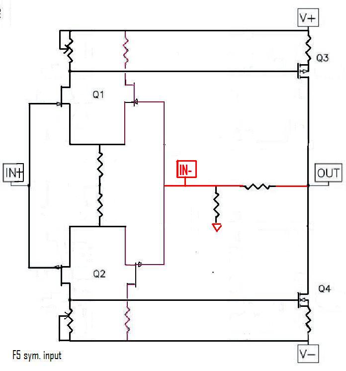

> That's one. I can think of a couple others...
Let me make a fool of myself :
Connect the source of Q1 & Q2 on each (left or right) half together, then connect these two junctions across the two halves with a 10R resistor. The feedback resistors are then 25R and goes from output to the source junction. Non-inverting then.
According to John Curl, this "H" diff pair has very good distortion cancellation.
Patrick
I do not have low idss jfet.All of them are above 8ma.Does not them work well ?
They will work very well, but are "over qualified". Keep in mind 2SJ074s are very hard to find nowadays. The F5 has P & N ch jfets at the input so high Idss jfets are not necessary.
GR and lowish BL jfets will work very well too.
I am matching BL jfets and will soon make some available to diyers. Some appear to be in the 6 to 7mA range.
Oh! I am wrong.
Most of signal will be amplified without feedback control.
Thx Wen-san, i understand my mistake now.
It seems there is no way to keep the 2 ways NFB with a symetrical input.
It has to be as follows. But nothing new then.
