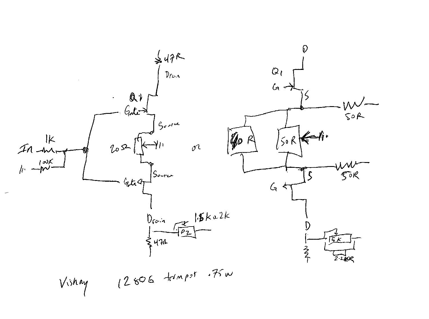

Nelson mentioned a pot referencing source pin to ground, to adjust sweet spot
I take it "source pin" is referenced to Jfet
Is it something like this
Yes, the Jfet source pin. The mosfet gates R13&R14 can be adjusted too. Looks like that would be safer as it only needs to be 1/4 Watt there.

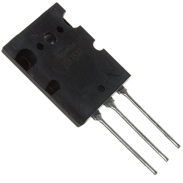

2sj201-Y/2sk1530-Y Toshibas mentioned by Thanh are available as guarateed genuine through ampslab, but expencive
Spencer lists 2sj200/2sk1529, matched pair
Hello
I believe the one which is single probably not original , not because it does not have made in Japan because on it , missing the category Y, R , O etc.
I have the smaller one 2SK1529 & 2SJ200 both marked Y .
I can be wrong but I ordered parts from Ebay and I get fake Sanken transistors !
They blow up whey you power them up at first time .
Even some small local store sale fake transistors in Toronto.
The best think to buy from a company like Digi-Key , Mouser , MC electronics etc .
You can be sure they are orig even do it cost much more .
Greets
I purchased from Ampslab JET-s and they were OK .
All I can say from Toronto I purchased some expensive transistors $17CAD .
When I tried to set up the bias both side the transistor blew up .Even the case blew up in to pieces .
32 people did built that amplifier successful . After I tried to find any error , nothing at all .
A broke one transistor good one and a small chip was inside .
100% fake transistors for $17 bucks .
All up to you .
Please ask Patrick he knows more about these mosfet .
He use them very often .
Just be sure before you buy , I lost at least $200 bucks on fake parts .
Greets

Regarding bias pots
Would someone please tell how to orient them
Original F5 schmatic shows the two bias pots mounted opposite each other
Others dont, but mount both the same way
There is a very good reason for 2W resistors in that position.
R1 and R2 are part of the feedback network and they see as much as one sixth (16,67%) of amp's output voltage which is 20V peak (max. value).
20V / 6 = 3.33V
Power dissipated on each of those resistors = (3.33 * 3.33) / 10 = 1.11 W (peak).
1/4W is OK only if you don't listen to your amp too loud. 😉

.... theoretical and actual experiences can differ.
No, they can't. Interpretations do.
...more people than just Peter Daniel have 1/4 watt in the R1&R2 positions without any reports of failure...
One more time, 🙄 power dissipated on that resistors is directly proportional to volume level that you use to listen to your amp. Without signal they dissipate from 0.25 mW to 0.4 mW (depending on JFET's Idss).
If you don't turn the volume knob past 8 o'clock you can use 1/16W resistors.
