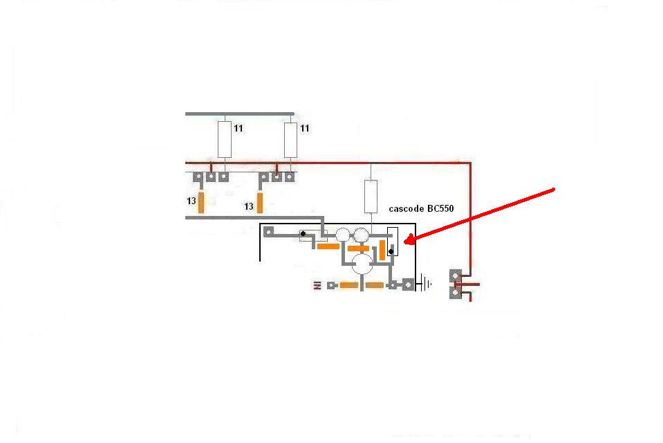

There is a trick worth knowing - You can use a potiometer
to reference to any point between Source pin and Ground,
tweaking for the sweet spot.

Nelson mentioned a pot referencing source pin to ground, to adjust sweet spot
I take it "source pin" is referenced to Jfet
Is it something like this
