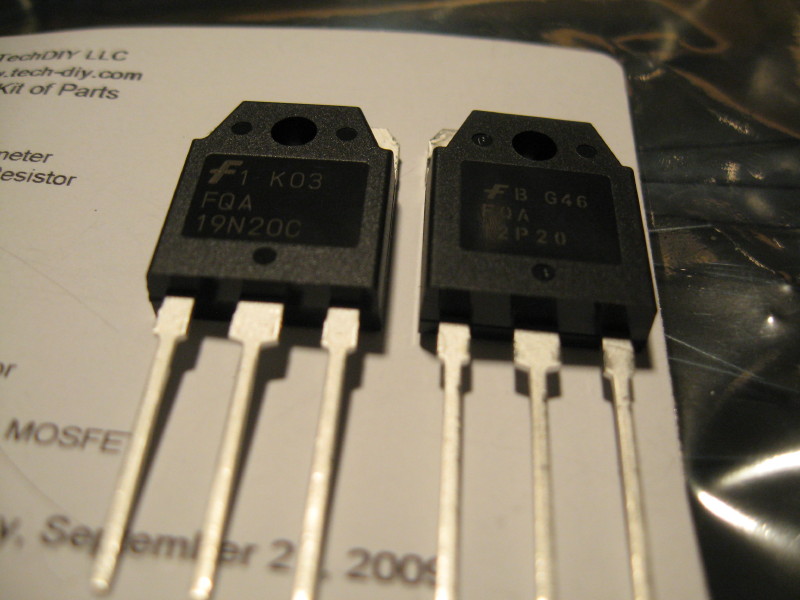

I'm only to page 222, so sorry if I havent got there yet, but was wondering what everyone is going to do now that FQA19N20C and FQA12P20 are discontinued? I ordered a parts kit from Tech-DIY, but was wondering if there is a replacement?
Thanks, back to the thread,'
Russellc
You can use IRF9240P's and IRF240N's instead.

Thanks for the reply. I ordered the kits from Tech-Diy with the IRF devices, and also ordered 2 pairs of the Fairchild devices, so I should be covered.

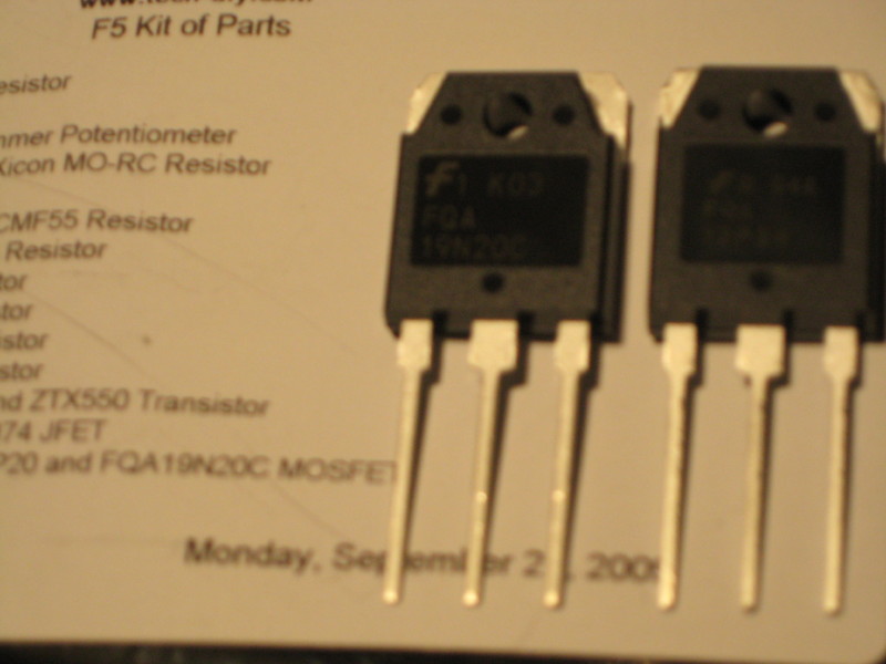

Russel, the Tech-diy kits are avaiable with the Fairchild FQA12P20 and FQA19N20C MOSFET's. I received these within the last couple of weeks.I'm only to page 222, so sorry if I havent got there yet, but was wondering what everyone is going to do now that FQA19N20C and FQA12P20 are discontinued? I ordered a parts kit from Tech-DIY, but was wondering if there is a replacement?
