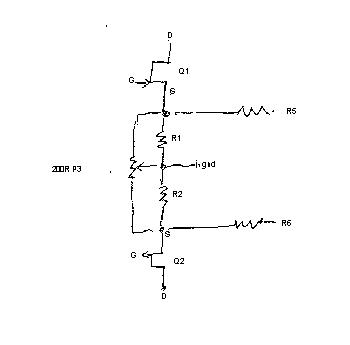

Nelson Pass from Post 169 FirstWatt J2 thread:
The IR P channel parts have higher distortion. You could use
the Fairchilds, or take a look at Toshiba or Harris (if you can
find them).
The N vs P channel mismatch is a small source of distortion
down around a watt or so, which is why you want to be
able to trim the Mosfet Source resistors values a bit (if you
have the analyzer handy). Also, it is effective to use a
couple hundred ohm pot, wiper grounded, connected across
the Sources of the input JFETs and trim for least distortion at
1 watt.
Hi Mr. Pass,
This was on the J2 thread but thought I'd ask here for the sake of relevance. Were you referring to trimming R11/R12? As for the 2nd part is my sketch correct? Not that I have anything to analyze with but perhaps I'll look for something on eBay if it seems worthwhile.🙂

I meant the 3 watt resistors on the Sources of the power
Mosfets going to the supply rails.
And yes, your drawing would be correct.
Either approach works - the pot is more convenient.
