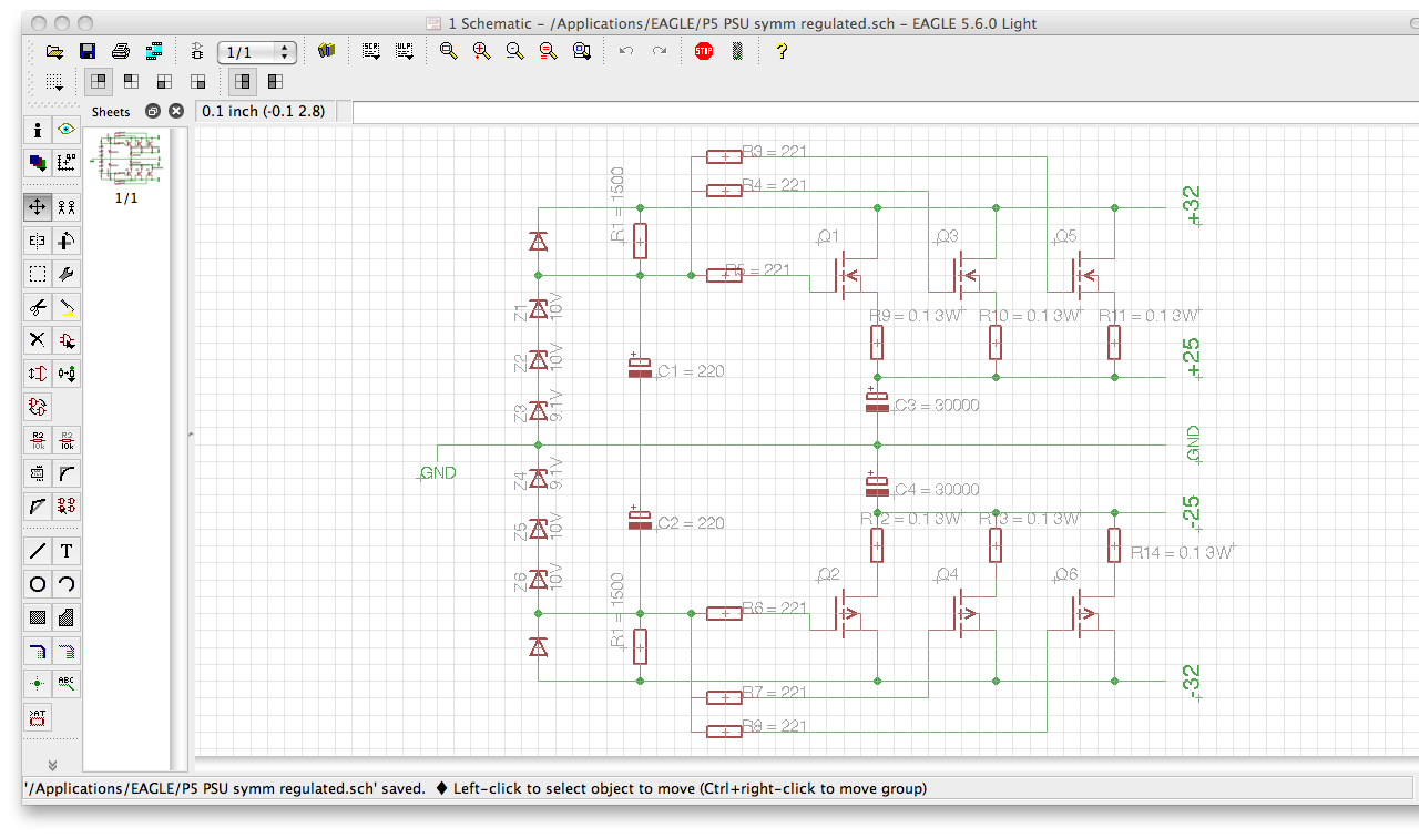

In my world its more simple
ClassD needs a very fast supply
ClassAB also needs a fast supply, but less
ClassA is on continiously and doesnt depend as much on such a fast supply
Switcmode seems ideal fore classD, yet some who have tried both switchmode and ordinary supply with big trafo on classD have stated that traditional trafo and caps sounds better
Switchmode is cheap, light and small, if thats what your priority
I am though very careful not to put too much weight on such statements
I might consider THELs regulated supply in his new symmetrical version, takes AC directly
Though, I still remember mr Thel himself writing that traditional oldstyle supply being the best sounding, if you dont need the voltage regulation
When a man who makes his living selling regulated supply designs say he favours traditional supply, then I tend to believe the man

does a regulated supply still need a big trafo, or would it work juast as well with smaller trafo ?
Burning 100watt continiously or maybe more, would such a regulated supply get very hot ?
