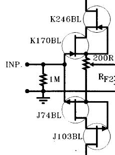

That is one way.
Another is to cascode like Borbely using JFETs, which is much simpler.
In this case, because of the 4mA or so bias, I would recommend using J111 / J174 as cascode devices (instead of 2SK246 / 2SJ103).
You should get a good 5V Vds on the Toshiba's then.
And yes, have done that many times in various circuits, including my AX-J 100W.
Patrick
