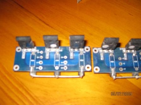

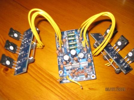

hi all
heres the pics of the output boards i want to add to the f5 for more power
i realise i will have to change the devices mounted to the baords
and already have enough of the f5 output devices to do this
the f5 will be run the same as the aleph 5 in the pics with 3x n and 3x p devices per amp mounted to the boards via flying leads
when i do this can i crank up the voltage and bias to get more power seeing as im running 6x output devices instead of 2
what sort of power can i expect into 4 ohm and what are ther plus and minus of this approach
regards sheafer

slr 5000 said:hi all
regards sheafer
B+ * (b+/ speaker impedance)
If using higher B+ then beware of power dissipation into output transistors and heatsink.
I usually use belt and braces and have a large heatsink plus a couple of fans, one sucking at one corner and the otehr blowing out at the opposite corner.
conversion to 3pair output stage
the maximum output power depends totally on the PSU voltage that is available when delivering that maximum power.
The maximum ClassA current depends totally on the bias current you set for the output stage.
The three FETs located near each other will defeat most attempts to dissipate the extra heat expected if you increase the bias by a factor of three and will be exacerbated if you also increase the PSU voltage.

slr 5000 said:i have some if i need to add more
in parralell
do i need to ?😕

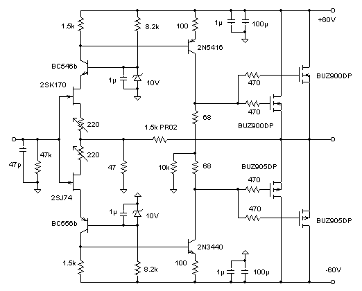

The input jfets would not appreciate to see more than 24v rails.You'll need to cascode them . Here is an example. (input stage only)
(Buzquito JM Plantefève)
- F5 power amplifier
