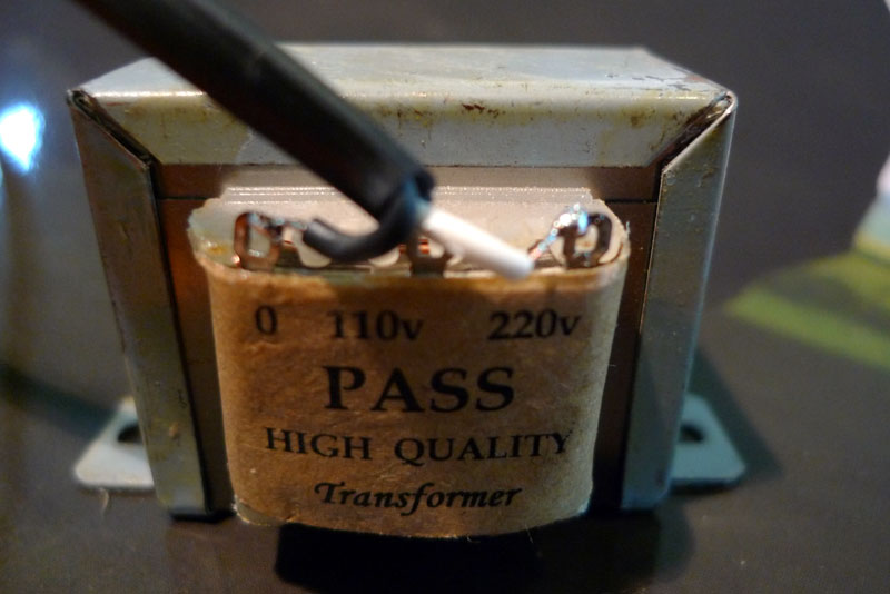

I can't resist sharing this picture of this little transformer from the Glodok electronic parts market in central Jakarta. I needed a small transformer to construct the power supply for the fans to slightly cool down my F5. Here's what I found.
I googled the so-called company and 'transformer' and nothing came up. Hmmm... ????
