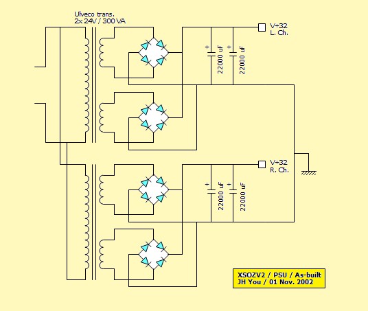

I suppose its not two transformers in paralel, but double windings on each transformer in paralel
One transformer on each rail
Problem is then whether transformers are matched closely to get excact same voltage on each rail?
JC951t said:Im afraid you can't parallel transformers.
One will run hot as I've discovered in my early
foray into diy audio
:bs:
JC951t said:Hi Jacco,
It's an experience that I had encountered
& this forum is about sharing experiences.
Hi JC951t,
you probably connected your transformers in a wrong way (counter-phase) and that's what caused your trouble.
You absolutely can parallel equal transformers.

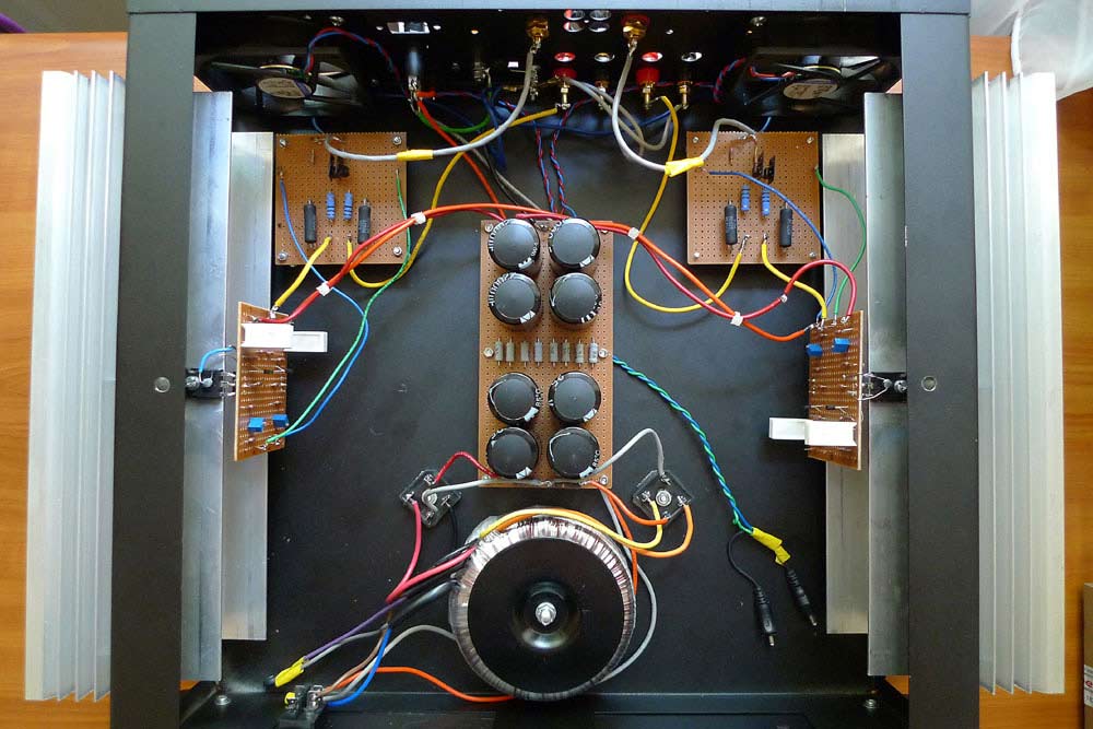

F5 is completed. The attached pic may be of interest to some who are considering a point-to-point wiring approach as opposed to using a printed circuit board. It was fun and challenging to build, but not too complex. The amp parts come from TECH-DIY, where I selected the Vishay/IRF hexfet kit. The power supply is based on the schematic shown on the last page of the F5 Operations Manual (with its included F5 construction article). Power supply parts and fans were ordered from Farnell-Newark Singapore. The fans’ power supply parts are locally sourced. The transformer is only 250VA – I could not find a 300VA unit through Farnell; it gets just slightly warm, but otherwise OK. The chassis and heat sinks were bought here in Jakarta at the famous Glodok electronics parts market – a dark, hot, crowded network of tiny shops that is actually a fun place to explore. The heat sinks were slightly under spec, therefore the fans.
The sound of the F5? It has a magical see-through quality! I’ve never really heard reproduced music with such ‘pure clarity’. My mainstay amp for many years has been an Audio Research VT-100 Mk II that I keep well trimmed. The VT-100 sounds beautiful, with a full-bodied and textured sound, and although the sound is wonderfully clear, the prime attribute would not be what one would call ‘clarity’, if you know what I mean. In contrast, excellent solid state amps that I’ve listened to over the years do have clarity as their prime attribute, but with very subtle shades of coldness, dryness, or a hard-edgedness. Not so with the F5. ‘Pure clarity’ is the best phrase I can offer at the moment to describe the wonderful sound of this amp.
If you are contemplating building the F5, then DO SO! You WILL be rewarded. Much help can be gained from this thread. Overall, careful planning of the physical layout was the key for me. The 6moons Audio review photos of Nelson’s F5 boards gave me permission to consider separating the input stage from the output stage on separate boards, connected to each other via the jfet drains and the output rail. It worked!
The attached pic was taken prior to my construction of the little fans’ power supply which works fine. Anyway, I am happy to provide pics showing details if people are interested. Thanks to Nelson and the thread participants for a wonderful construction adventure!
-Steve
