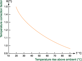

Is this heatsink - 350AB length of 200 mm http://www.farnell.com/datasheets/316955.pdf good for one ch - 0.42 C / W

C/W = (Tmax - Tamb) / Pd
Tmax = 55C (best "finger touch test")
Tamb = 27C (worse room confort, no air conditioner)
Pd = Watts of power dissipation per hestsink extrusion block
C/W = (55-27)/68 = 0,411.. Poor margin IMO. You need bigger heatsinks, lower C/Ws.
Hope this helps. Cheers

Heat sink thermal resistance
Make sure you know, (or calculate) your heat sink's thermal resistance (C/W) the desired temperature rise above ambient (30-35 degrees C). Most are quoted at a temperature rise of 80 degrees C. Heat sinks get more efficient as they get hotter !! See attached for an illustration.
A stereo F5 or bridged mono F5 must dissipate ~ 35 watts PER FET. This means a total thermal resistance of 0.25 for a stereo amp at a 35 degree C delta T.
I am waiting for barrredboss's new extrusions, before I select a sink for my bridged F5's The more I've looked into this, the more I agree with Pass.....if you want your amps to last until you're deaf, dead or the sun goes out, (whichever comes first), you can't choose sinks with too low a thermal resistance !!

One thing I have had trouble with when coming up with a good heatsink is not just the Tsink-avg, but the Tjunction. The Tj is probably your most critical parameter for longevity. The TO-247 Device max operating Tj is 150Deg C. Nominal operating temperature is 74Deg C. I think Mr pass has indicated a good comprimise is about 100Deg C.
It takes a lot of effort to get a TO-247 dissipating 32 Watts to operate under 100Deg C. Bodging the device to the heatsink will not work for a device operating in this range.
Here is some advice I recently recieved from a Thermal Engineer at R-Theta.
"All three options will lead to the same results if the input is properly entered. I typically use W/m.K and thickness for the thermal interface. The thickness is quite critical. It could mean a difference in 10-20 degrees higher in the simulation program if you put it too thick.
Personally I don’t like using thermal impedance (C.in2/W) because the value will have to change if you change the device size. Temperatures can get out of hand pretty quickly if you don’t adjust the values.
If you have a working thermal resistance (C/W) for the interface, then it is easiest to work with"
