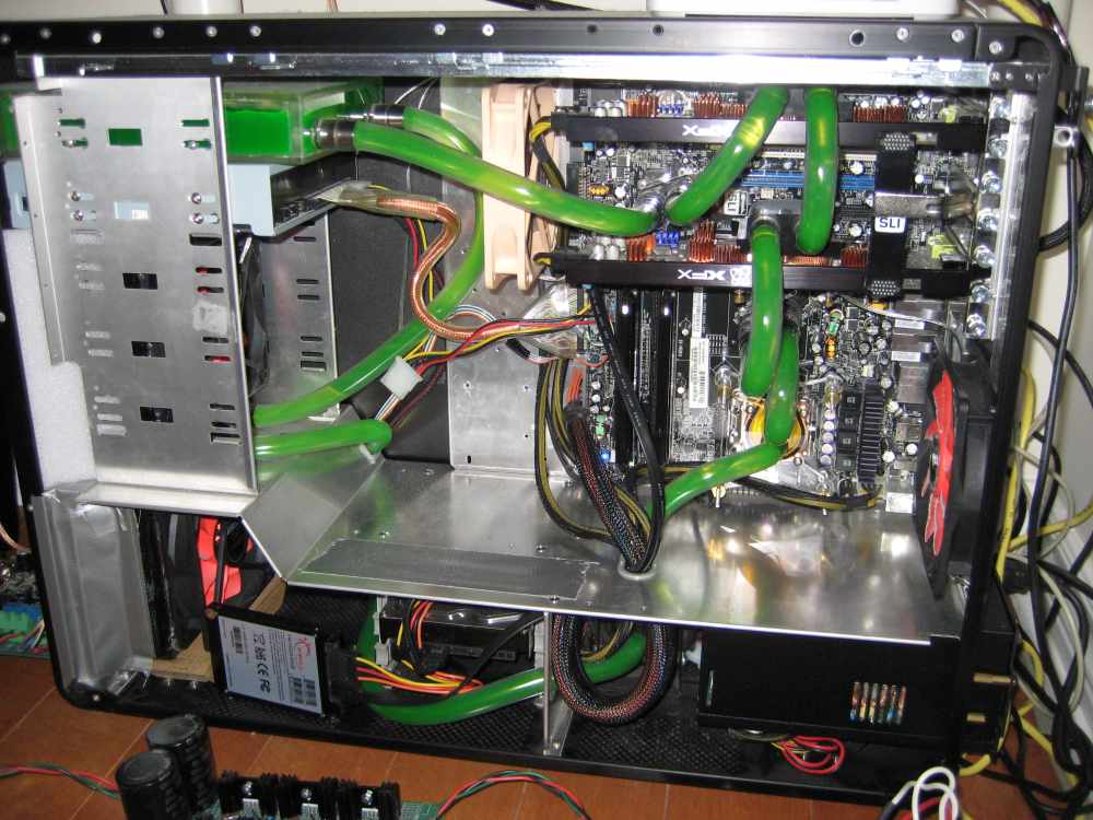

From my experience with PC cooling, water really is great, and yes, I suppose a transistor mounted to a block of aluminum is probably a little old fashioned when you look at it next to the more sophisticated systems in PC's. In the end though, computers are all about high density, and that's why water cooling makes sense in that application. Hi-fi amplifiers on the other hand, don't really need that density, or that level of cooling.
I've attached a picture of the water loop in my PC, so you know I'm not talking out my ****. The PC draws a constant 355 watts from the wall, and closer to 650W under full load. It keeps my office nice and toasty all year round, but at least it's quiet, which was the point of the water cooling.
Tossing your computer in a large vat of oil is all the rage right now in the PC cooling world. Maybe you could toss your F5 in an aquarium full of oil, seal it up, and toss the whole thing outside. I think connectivity could become a little bit of an issue though. Maybe you could try different oils and see how it changes the sound? I bet EVOO would sound best, but only cold pressed.
