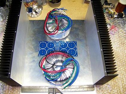

Re: Finished my F5 --- tms0425
tms0425, I'm getting closer to an F5 build and I'm curious as to how you attached the wiring to CVillers boards. Wire gauge used.
I've yet to find a way to setup two F5s in balanced mode, and I'm hoping the Conrad MF35-151.5's will handle the heat.
The remaining parts from Digikey arrive Thursday, so maybe by this weekend I'll hear
what everyone has been talking about.
tms0425 said:I finished my F5 with CViller's power supply and amp pcb's to keep my pair of F4's company. It went together really easily and biased up with no problems at all. Thanks Christian and Papa for this little gem!
Antek toroid, TSHA 22k uf caps, PRP resistors, etc. Nothing fancy.
Tom

Nice looking box there ichiban.
Tonight I made more progress... but first a step back. I took and then labelled a pic of what I did with the output resistors. Seems that its part of my penance to show it all but maybe it might save some other poor soul. Morgan Jones talks in his book about never working when you're tired or late at night... well its then or never around these here parts! The boards are messy, bits having been soldered in and out a good few times so excuse the looks ok?! So look, if it saves anyone else...
and here she is powered up in the workshop, front face on, lid in place. I ended up painting it a nice shade of metallic green. I have it inside now playing a disc but am about to head downstairs and have a listen before bedtime. thanks again to Nelson, Peter and all who helped out here. everyone.
Fran
Fran

I wish I had some of those nice milled and drilled Conrads. Very nice 😀
I'm not really sure you'll have enough dissapation to put 4 channels of those 2 sinks. If I recall it's 62w each, so might be tough with 4. Also, that layout of toroids will get one of them VERY close to the signal wires on the back panel. If you want to try it I would mock it up with the supply on the bench, handwired to 2 boards first, then try a 4 if all goes well. Instead of tapping the heatsinks for all of them right away, I would be inclined to use flat bar stock temporarily clamped over the pairs of Mosfets. If it won't work that way in free air, the closed case with toroids inside definitely wouldn't make it. With all that said, my pair does not run as hot as I though it would. The F4's run about 45 C biased up a little harder than Nelson recommended.
I used 16 gauge for V+/V-, power grounds, AC wiring, doubled 20g Cardas for the speaker outputs, and 1x22g Cardas for the signal input/grounds. You could go bigger as the holes are very oversized.ichiban said:

Re: Re: Re: Finished my F5 --- tms0425
Just adjust the bias until the sinks run 50-55 deg C, and there you are.
tms0425 said:I'm not really sure you'll have enough dissapation to put 4 channels of those 2 sinks.

Thanks guys. funny you should mention that old oak.... thats exactly what this was. It was a board from the kitchen table in the house I was born in, since derelict and so has senimental attachment too. Can tell you though, it was a bitch to plane. Whatever crud got into it over the years (the open grain is actually black) I wore a set of planer blades to blunt bringing just a few boards back to true. Nice to have it though.
Some details, I'm using a 12" x 6" x 2" heatsink per side and it gets good and hot, at least 50 deg each side I reckon. I can hold my hands for 10 secs ok, but it gets uncomforable after that. My DMM with temp probe is outside in the workshop, will get an accurate measurement tomorrow night. But right now, you need that size of heatsink for sure. I'll be checking bias again tomorrow night to be sure to see how it settles out.
Sonics: well I've only had a short listen, couple of albums, but initially, the sound seems very refined. My initial impression is that it has the best qualities of both my EL84 amp and the mini aleph. Has a really nice airiness to the highs. Seems to be a little lower gain than the mini-aleph too, I seem to have the volume knob up a little more on the pre. Bearing in mind this amp has not been running for more than 2 hours, it sounds very good - well worth the build and I do think it improves on the mini-aleph. Maybe its just the extra power of course (mini was 10wpc) but there is a lovely kind of unforced nature to the sound. Need to try it out on some dynamic speakers too (mine are quad 57s).
Thanks to all.....
Fran
Thanks to all.....
Fran
