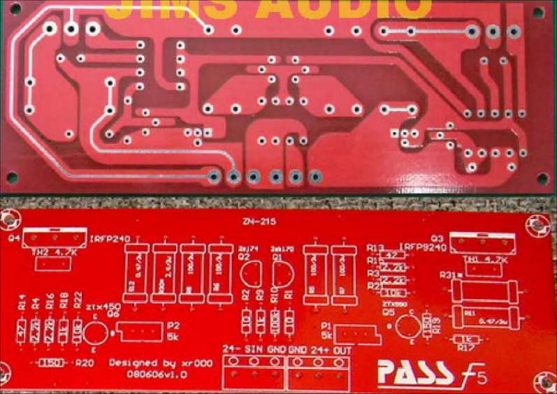

Re: ebay pcbs
I don't know about the pcb - it looks fairly nice, but I haven't looked into it in detail. It does however seem to violate the PASS logo.
Any particular reason why you want to buy those boards instead of those offered at the two group buys?
juluska said:What do you think about that pcbs that sold on ebay?
I's worth a try to build that kits?
