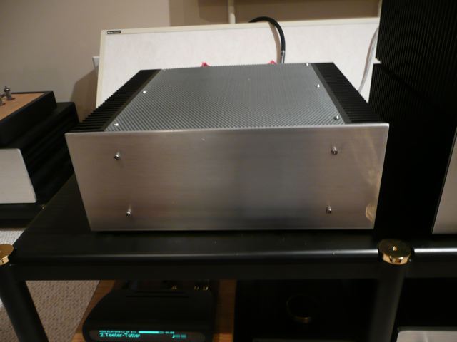

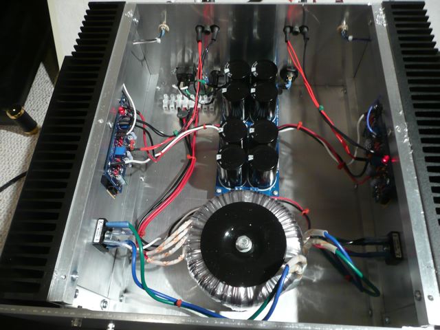

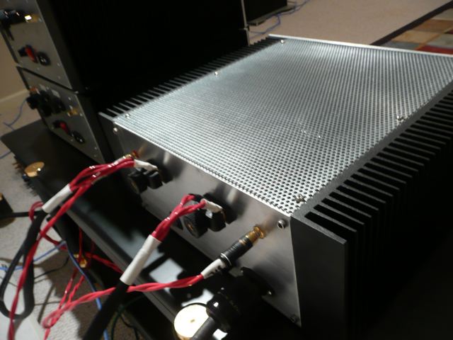

Finished my F5
I finished my F5 with CViller's power supply and amp pcb's to keep my pair of F4's company. It went together really easily and biased up with no problems at all. Thanks Christian and Papa for this little gem!
Antek toroid, TSHA 22k uf caps, PRP resistors, etc. Nothing fancy.

Just keeping my options open for higher power F6, F7, ...F99 or whatever... 😉 I do have a few more F5 boards and a couple tubes of Mosfets just in case. One F5 should be fine for the CD/waveguide mid/tweet of my CS2's with Pumpkin @15db to balanced mono F4's on bass.Zen Mod said:

Nice work on the amp.What is ther mesh made from on the top of your amp ? Looks like a good option for ventilation and economy.
dave
