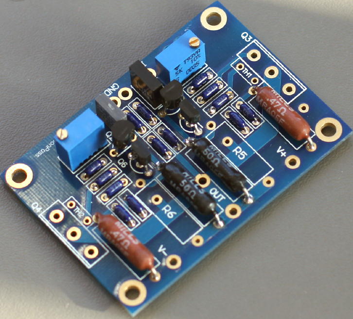

Note that the Tech-DIY parts kit needs a bit of work to mount properly on Peter's board. The resistors are all mounted vertically and the Ohmites mount to the back of the board. Can take a while to figure out how to mount these on a chassis this way...

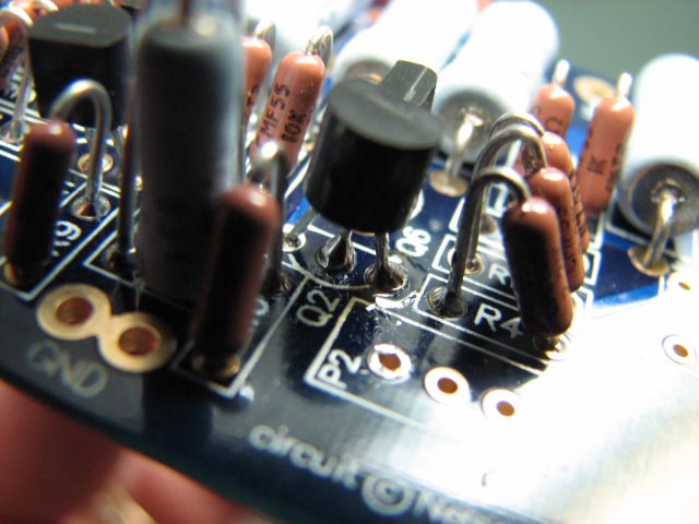

I just used the standard Tech DIY parts and stood the resistors up soldier style.

The board was designed to be used with Dale CMF50 resistors, available from DigiKey: http://dkc3.digikey.com/PDF/C091/P1890.pdf
For the large ones, use 3W Panasonic metal film, also avaialble from DigiKey: http://dkc3.digikey.com/PDF/B092/P1920.pdf
You may also consider 5W Mills and then use single 50R resistors replacing R5/R7 and R6/R8 parallel combos.

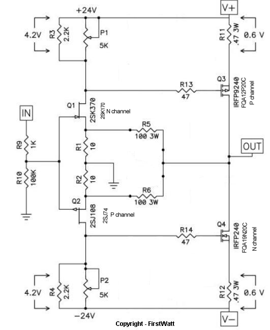

I would also suggest simplified amp circuit, without protection circuitry and thermsitors; it really works nice and according to others sounds better. Since such version uses even less parts, you may also consider Caddocks or Vishays: http://www.audiostereo.pl/zalaczniki/1272620_1.jpg

What is th evalue of gate resistor ?
Mounting on leads from the outputs is sufficient. There are additional holes for standoff mounting as well, if someone wants to use wires to spread devices further way. It's been confirmed previously that even 12" wire runs shouldn't be a problem, but 220R gate resistors should be mounted directly on devices, not on the board.

1) What is the correct value.of the gate resistor ? You mentioned 220 R but the F5 circuit shows 47 at the positions of R14 and R13.
2) Do i need a certain gauge and 105deg rating wires ?
