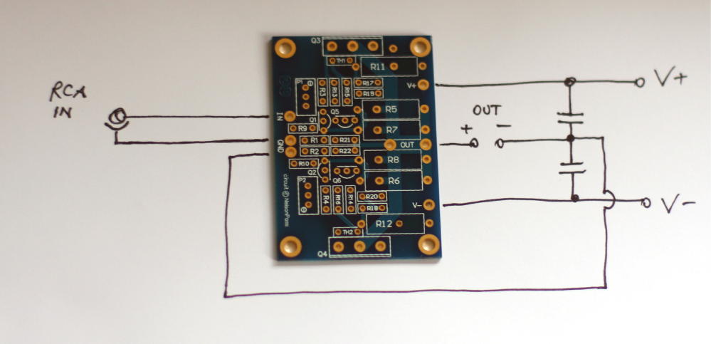

See this 🙂
http://www.imgx.org/public/view/full/19271
The power resistors go on the other side of the board...
Thanks guys, I think I'm clear on parts choices now. Peter, I received two power supply boards that appear to have two power supplies each, did I receive an extra accidentally, or are all 4 required? Seems like I recall a post with pic showing how all this (power supply and amp cards) hooked together.
I think I'm going thread blind from building this and a 45 tube amp at the same time! Thanks for the patience with this old tube man! Any pics of how the 4 boards wire to the amp cards would be appreciated, obviously I was mistaken in how I thought it went.....😀 And by quite a bit!

Nice shot! Should keep me from reversing the transistors!
The amp requires symmetrical supply (+/-V). Each PS board supplies both positive and negative voltage, and you can use one per channel (separately).
