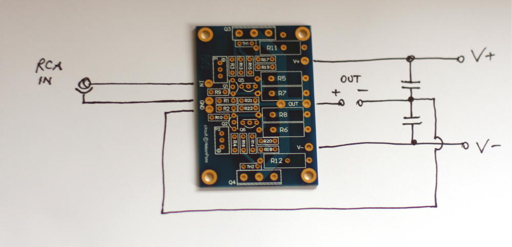

f5 gounding scheme
Peter

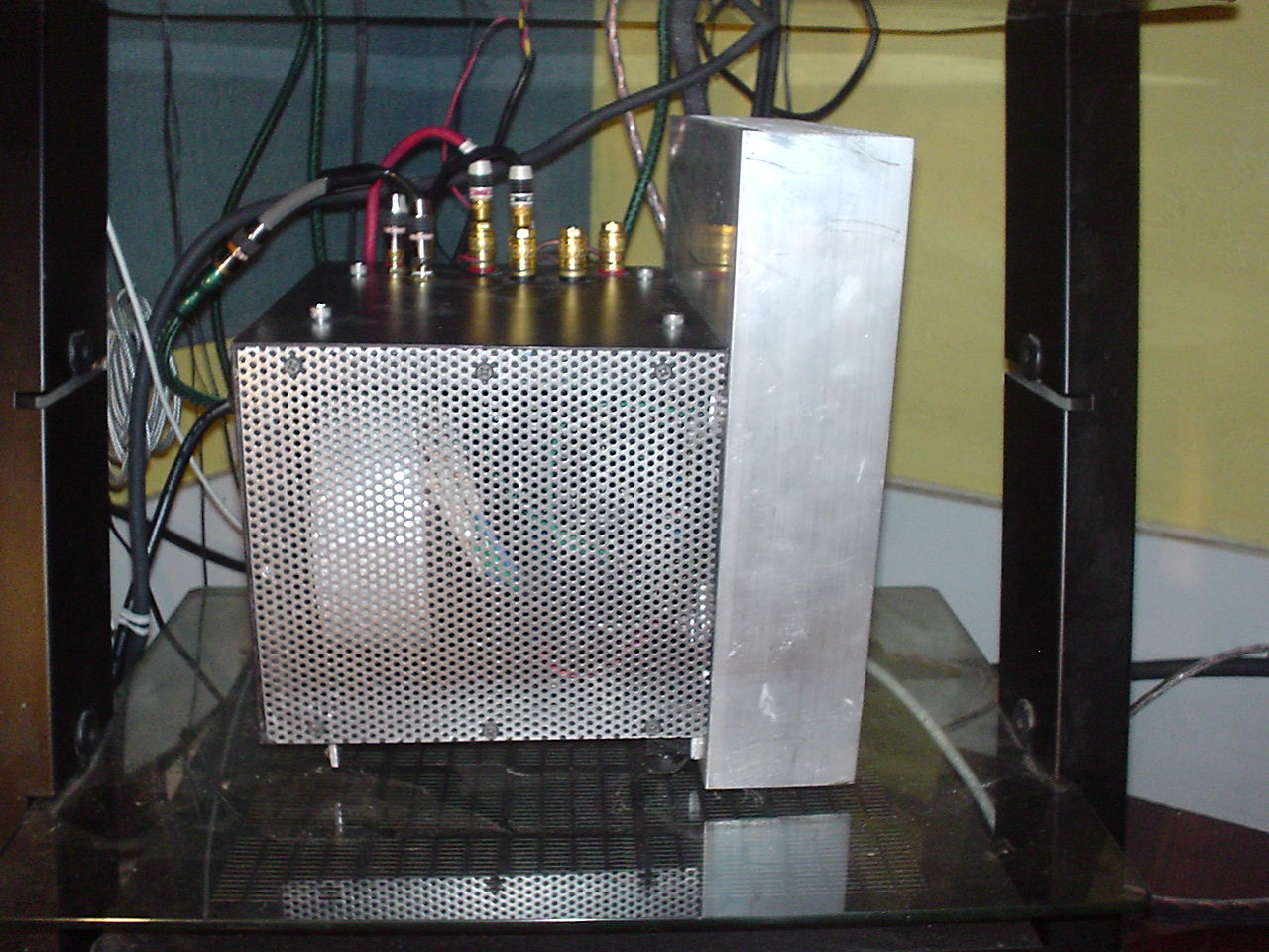

Awhile back,discussion, and occasional confusion, ensued over proper grounding with your boards. You stated that you supplied a pad with two locations for ground. One hole for the incoming signal and one for connection to the PS ground located between the caps where you suggested the speaker ground should also be located. I have built three sets of amps with your boards and on all of them I have used the cap/speaker ground as the location for my input/output ground and have a very low noise level , no turn on thumpage generally well behaved little puppies. It essentially looks like a professional star ground design.
I also have eschewed the current limiting and thrymistors and followed NP's suggested feedback modification and your suggestion to biamp instead of bridge. I am using barrolboss's large heat sinks oriented vertically(10"w x12" h) and they do run hotter than my fan cooled version , typically40-45 degrees faranheit over ambient temp after one hour of power-up. I am now two months into the listening and am quite pleased. They do sound better after 30 minutes or so, I believe the bias settles at that point at around 1.15 vdc.
Just thought I'd check in and hope all is well with you
take care
rob
Hi Rob, The signal ground and power grounds should be separated. If you connect the input ground directly to "cap/speaker" ground, that could be causing that low noise. The input ground should be connected to the amp board first and then to common ground on caps where speaker output ground is taken from.

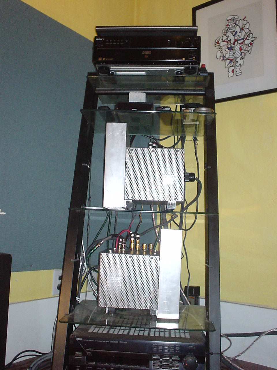

TP THERMiSTER OR NOT- WHERAST GO THOU?
hI pETER
i MOVED THE GROUND YESTERDAY AND BELIEVE i HEAR mucho better detail- thanks berry much- I heard a yawn towards the end of "I"m only sleeping"(REVOLVER) that I'd never heard before-
yeha baby this is the good stuff!

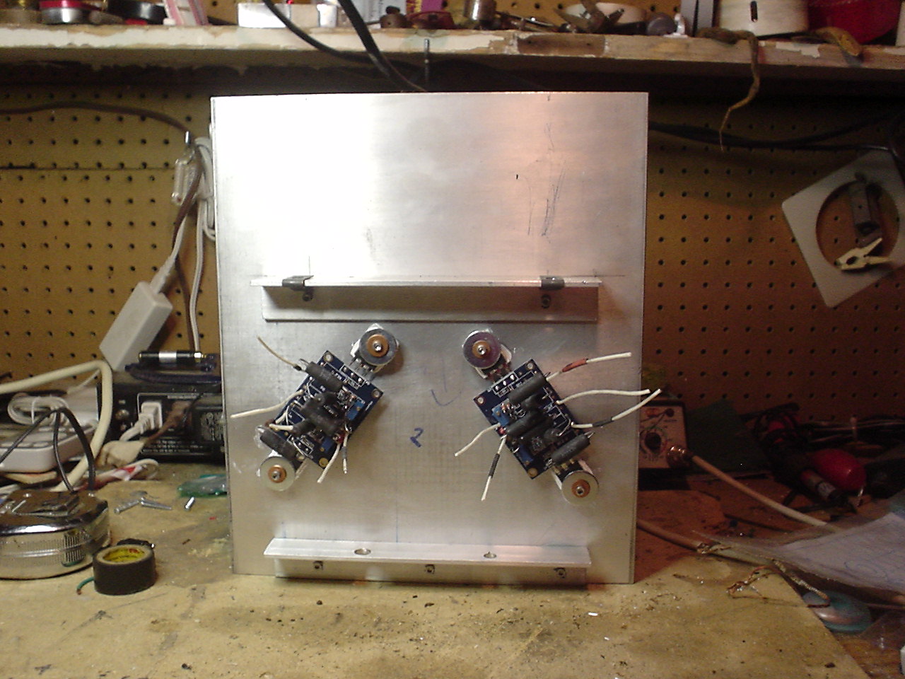

I've included some pictures for your viewing pleasure-enjoy!
